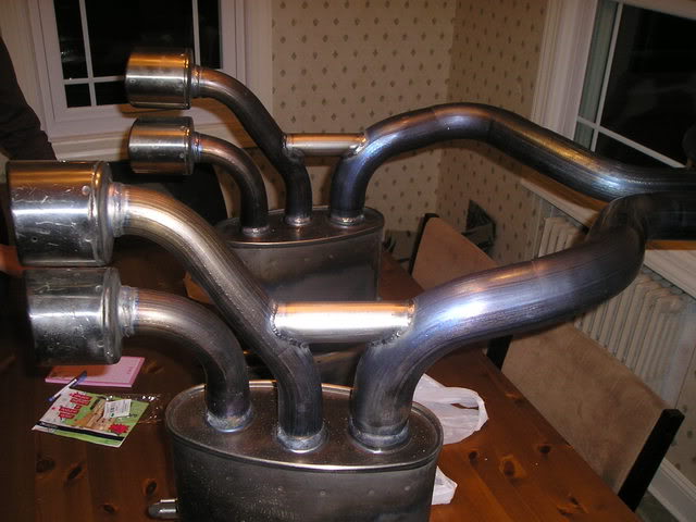

A very popular mod to do to many cars. Same concept, I did this to my '02 Z06 but it was a little more invoved - as the stock exhaust is Titanium and the additional tube and wlding rod needed to be titanium. The resultant sound was quiet at cruise and incredible at WOT.
Must be cold in the garage, kitchen is better.

Originally Posted by rico930
I’ll do one better and show you what you guys are actually doing. I did this as the #1 mod but wanted to see what I was actually doing or if there was a better way. I ended up dropping the exhaust and cutting the top half off to see what went on in there. It was horrific to see the number of sharp turns etc on a turbo car ! I ended up using a hole saw the same size as the exit pipe and letting the pipe wall be my guide to an even cut. I remember it sounded like I thought the car should have but not to obnoxious. Sorry for the crappy phone pic it was all I had before I tig welded to top back on.
