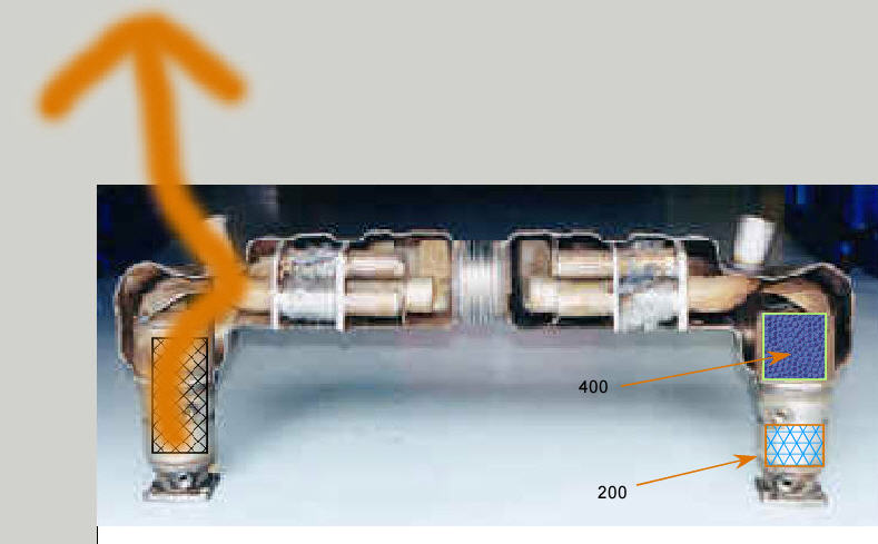

Originally Posted by RichardCH
To be honest not sure I have them anymore as that was before I had a full digital Camera in 2003. Essentially what we did was put the exhaust upright in a jig and used a grinder to split it on each side between the 200 and 400 cell cats. We drilled out the large rear 400 cell cats (you will save quite some weight here) and then from what I remember we used a mechanical press to push out the 200 cell front cats. We then used a mechanical saw to shorten the FVD 100 race cats, pressed them in and welded it all back to together in the jig to be truly honest its probably 3 hrs work on the exhaust per se and then +30 mins each to take the exhaust off and put it back on (but you need two people for this) so its not a small job. I had my upsolute stage 2 done at the same time, a very worthwhile day
I am assuming the big one after the turbo is a 400...could you take the attached JPEG and draw in the parts removed and the parts changed....to make it easier on me (and for when I go to my shop)....
Which is 200..which is 400... where to cut...etc.
THANKS!!!!!!!!
jeff
Old Jan 13, 2008 | 08:46 AM
  #206
jcb-memphis's Avatar
Joined: Jun 2007
Posts: 2,141
From: CIR PCA Region
Rep Power: 134
jcb-memphis has a reputation beyond reputejcb-memphis has a reputation beyond reputejcb-memphis has a reputation beyond reputejcb-memphis has a reputation beyond reputejcb-memphis has a reputation beyond reputejcb-memphis has a reputation beyond reputejcb-memphis has a reputation beyond reputejcb-memphis has a reputation beyond reputejcb-memphis has a reputation beyond reputejcb-memphis has a reputation beyond reputejcb-memphis has a reputation beyond repute
Here is the image. Orange is the TJW flow path. Thus, the medial stuff can be ignored I think.....chime in anyone who can help.
Thanks Richard.
Jeff

Let me root in my work email tomorrow may still have some pics there, the 200 cell cat is straight after the turbo, the exhaust then widens out for the second larger 400 cell cat after the 2nd Ob2 sensor (thats why removing the 400 cats gives you no check engine lights !) I would seriously guessimate just splitting the exhaust & drilling out the rear 400 cell cats would in itself produce big results and it ie 1/4 of the cost (no buying new cats) and 1/3 of the time that in itself is pretty easy of what I actually did.

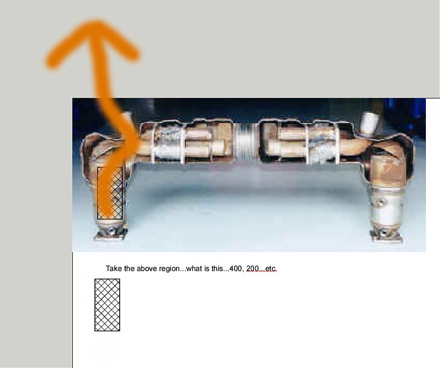

Originally Posted by John D
Jeff,
Be sure to monitor this project closely...If this is not done in a jig with exact measurements, the exhaust will not hang properly and fitment will be a problem. You have to make sure you keep the exact factory measurements or you will have problems when you go to re-install it. If it is not done perfectly, it will put undue strain on the turbos/headers, etc., as well as, result in uneven tips at the end of it all.
Scott,
Of course I did...Sorry, but I don't buy it. The comparisons were done on two different days with different conditions and from what was described, the results were all over the place - just trying to get a baseline. With the dual cats in place, the exhaust is still so restrictive that IMHO, any power gains have to be miminmal. I believe it was also stated the peak power did not increase, but a few areas under the peak did. Personally, I think that the drilling of the hole is great if you are looking for sound, but if you want to maximize the performance of your car, you should be looking at properly designed exhausts with maximum performance inherent in the complete design.
John,
Will do...but I have played with the system and I think it could be trivial IF the following is the case
If there is a gap between the 400 cell and the 200 cell....then removing and or grinding the 400 out will do it enough for me.... I suspect making a window after the second 02 hole and going for it is all it will take now that the TJW is in. I don't have to "add" a cat at all...the 200 is in place. I would have though 400 first...but I guess we got lucky.
Here is the idea....Richard, please pipe in.
BTW, if you don't cut the casing completely apart, it is so stiff that I cannot imagine any problems down the road at all. Just me. Cutting from the part on the "upper" surface will be the smart way to go....more cosmetic from bellow later....wonder if there is a way to get the 400 out without changing the shell too much...
Richard, is there space between the cats?
So, this is what this dealer type was doing way back when....nothing is really new...
