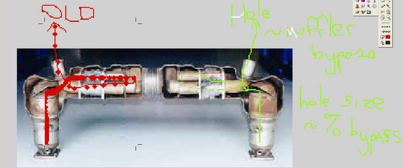

Hello Ken, so you don't touch the baffles etc in the silencers you just remove the 400 cell secondary cats ? this is I know is a major job it cost me $1000 alone.

Brad Bedell is a splendid one to beholdBrad Bedell is a splendid one to beholdBrad Bedell is a splendid one to beholdBrad Bedell is a splendid one to beholdBrad Bedell is a splendid one to beholdBrad Bedell is a splendid one to beholdBrad Bedell is a splendid one to beholdBrad Bedell is a splendid one to behold
I'll add, this is a big job. I had a full afternoon into mine and it's not nearly as clean as Ken's. I put 100 cell in mine a couple of weeks ago. With stock tune, the 100cells were not 'enough' to burn off the exhaust smell. With the EPL tune, the car burns cleaner than it was with the 4 stock cats.

RCH is just really niceRCH is just really niceRCH is just really niceRCH is just really niceRCH is just really nice
So Ken you also cut out/off the cap immediately behind the 400 cell cats (which looks like a pacman) in the attached pic ? are there no benefits to reducing the length of either of the pipes facing into the center section ? i.e cutting one or both flush with the 2nd section joint ??
So Ken you also cut out the cap immediately behind the 400 cell cats (which looks like a pacman) in the attached pic ? are there no benefits to reducing the length of either of the pipes facing into the center section ? i.e cutting one or both flush with the 2nd section joint ?? Or at least cutting the outlet pipe in the baffles section to the same length as the inlet pipe ?? What differs with the 996 GT2 here
