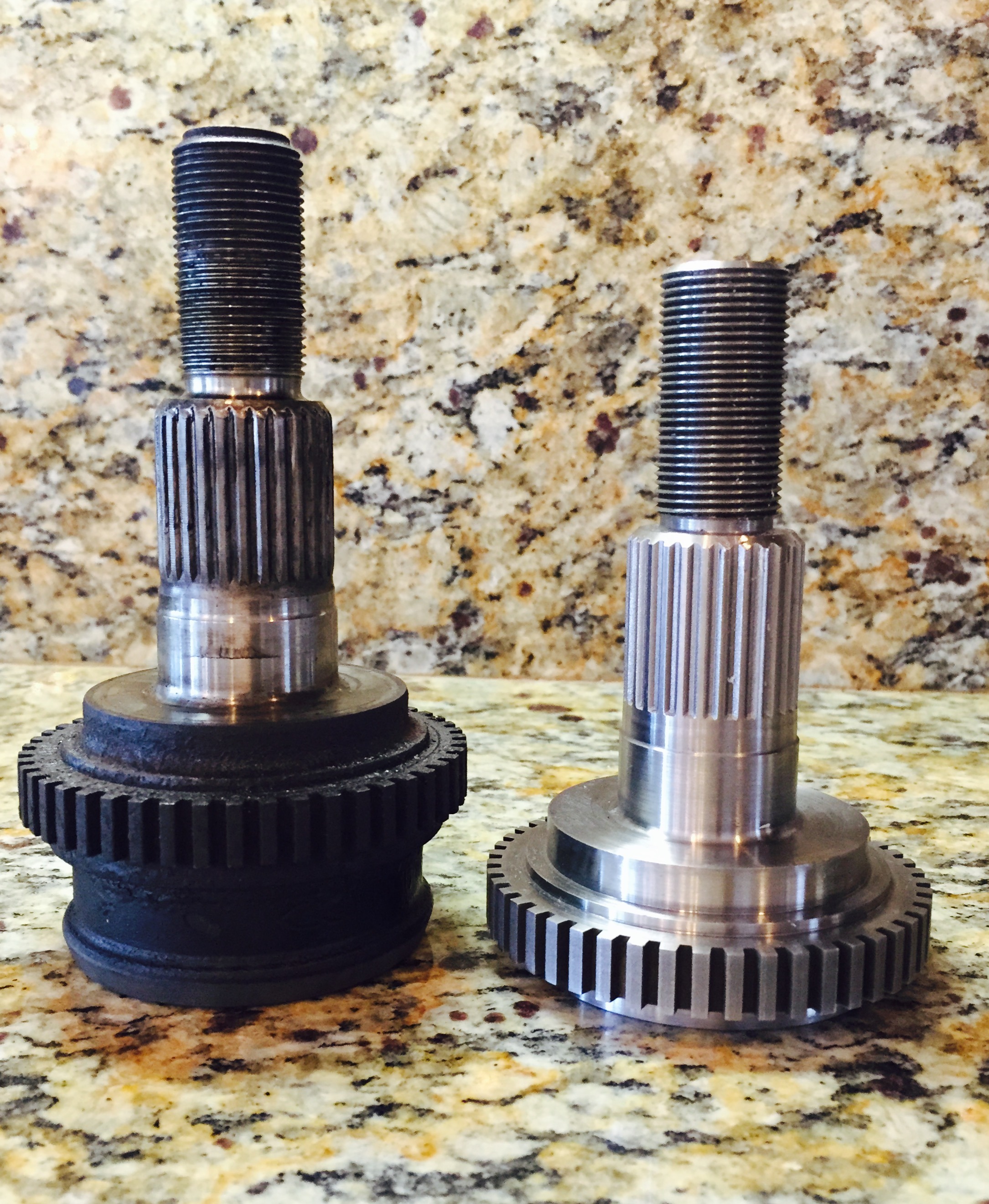

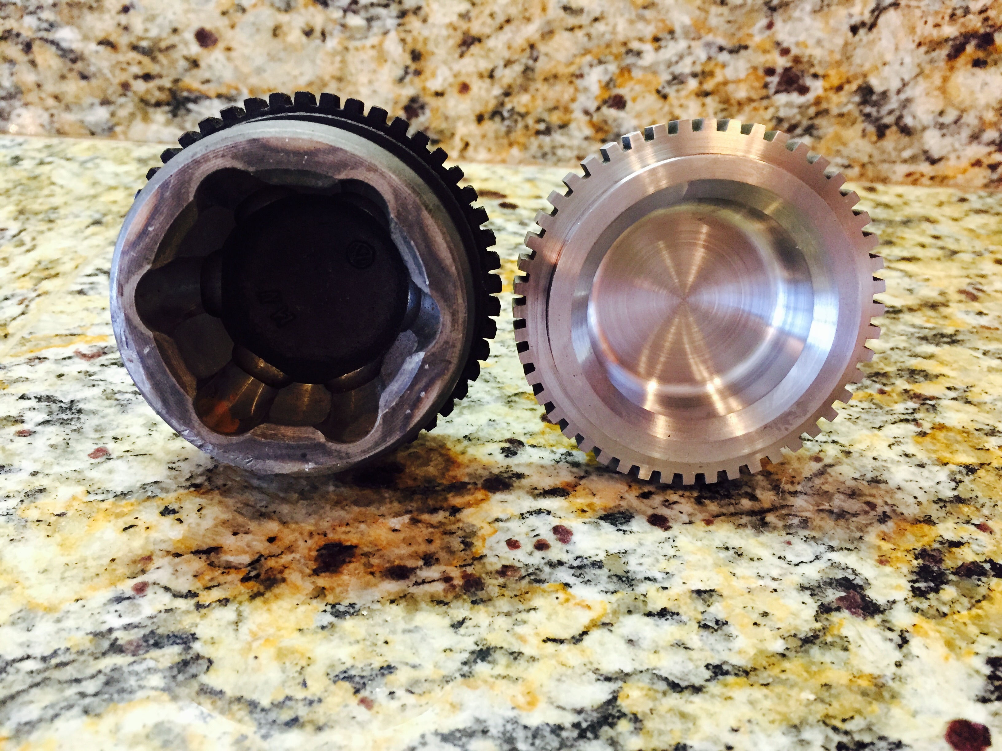

Bumping an old thread. I converted my TT to RWD and love the driving characteristics. I took the conversion a step further and made my own axle delete stubs. They weigh half as much as the broken down CV axle stubs, allow for the stock axles to be swapped back in whenever you want to go back to AWD and there's no need to disassemble the CV joints.
i am nearing the completion of the rwd insofar as i/m running rwd only have all the parts and already run the wavetrac etc. just need to stub the axles! have the gt3 parts etc.
how did you accomplish that? it is beyond my pay grade no doubt, but i'd like to be able to keep my original axles if at all possible!
ya never know, it could snow out here lol
I basically cut off the fat from the axle stubs associated with handling power since it is no longer needed with the 2WD. The hardest part was getting the speed sensor gears to match perfectly and the correct metal to have proper magnetization.

thx for that info. will give it some serious consideration. i am determined to complete ( properly ) my rwd conversion and get rid of that infernal hanging front diff and fix the front end geometry once... and for all
in the meantime rwd with tbd lsd is a gas. heavy front end or not! it's insane

your stub looks good! Too many irons in the fire for me right now, had to put the machinist on hold that I had contracted to do my work. I don't think Ti would work for the speed sensor rotors as it is nonferrous. You need iron or steel to create and interrupt a readable magnetic field to get the signal.
Are your take off stubs available? I need something to reference and don't particularly want to take my car down this time of year.
Yeah, you gotta drop the front half of the driveline. That's where all the weight is. Although having an LSD would be a lot of fun.
Skipped out on making a run in Ti because of the weight savings compared to the price to manufacture is only rational for a select few. But if someone was interested in Ti with a steel ring for the speed sensor, I can make a set.
My OE stubs are spoken for, sorry.
