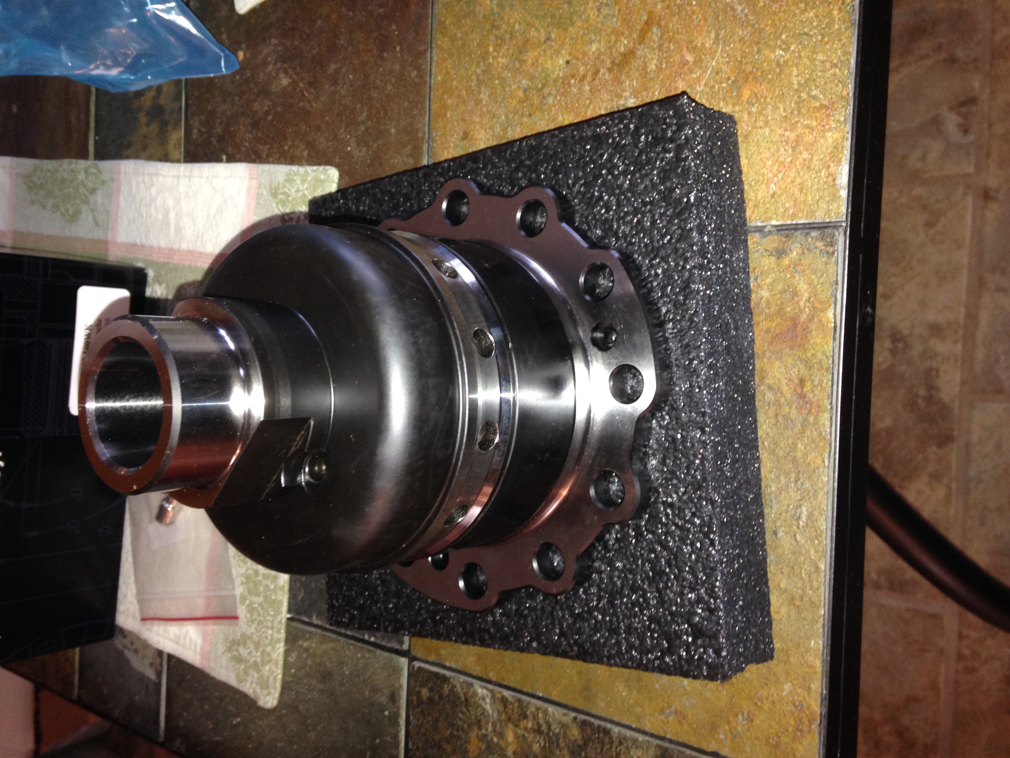

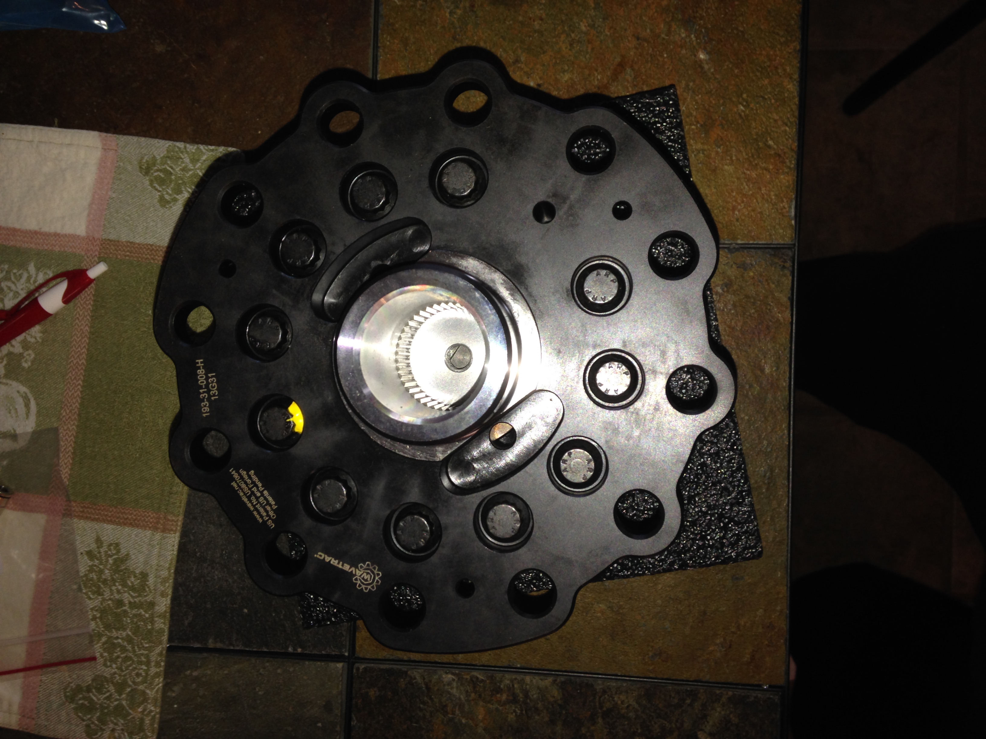

I recently had a front axle fail so I did the rwd conversion removed diff, driveshaft and used my axle stubs. When I purschased my car I was told it had a wavetrac installed but after I removed the awd With the car on the lift i can spin 1 one rear wheel with no effect on the other. Is it possible the clutches are bad or more possible I was lied to. Either way very disappointed. All my knowledgeable Porsche guys said i was crazy for running awd if I had an lsd. Other than that I love the car rwd current set makes 530rwhp very fun can't wait to get some fresh tires on it and work on some launches.
Not crazy for running both, but you dont need both for sure. Especially if not on road course.
this is what the wavetrac looks like. i have it installed in my turbo. if you can see the spider gears in the diff you dont have a wavetrac
