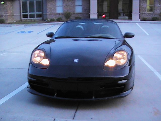

Originally Posted by Gary in BR
I have had my lights tinted for 2 years and there is absolutely no purple or moisture issues. If I have to replace the tint every 3 years or so it only takes about an hour for both lights.
I like this...and it has the plus of being "cheap" and "easy to remove"...that is huge for me. It look great. Please share your thoughts on the fogs....how much can one see with the tint on (what tint is it?).
Thanks. Looks great, less billing.
Jeff

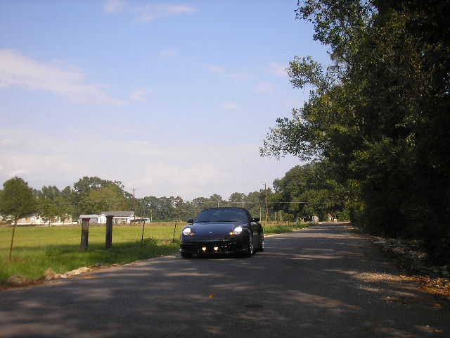

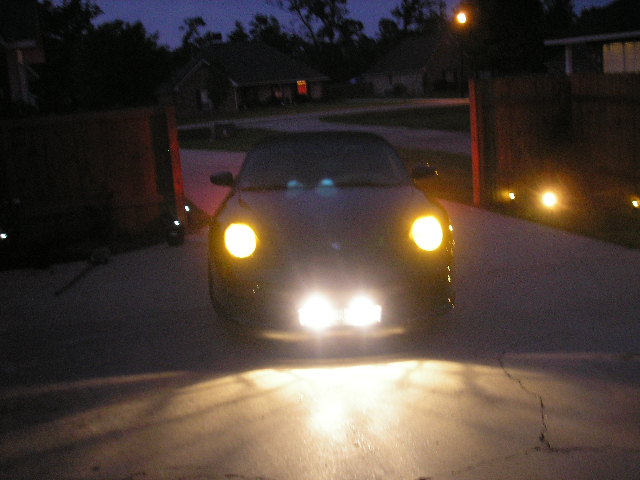

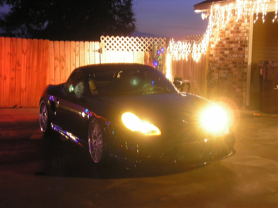

Jeff
They are cheap and easy to remove. And you can vary the tint. At one time I had the dark tint like now but had the lighter tint on the fogs. It looked good (no pictures sorry) and worked just fine. I tried to put a clear film over all of it to seal it in and in that process I ruined the entire tint job, that is why everything is dark now.
The fogs are about useless, I knew that going into it so I replaced the fogs with a yellow bulb. The yellow looks really good. And it helps be be seen. But for a useful purpose the fogs dont have any.
I added another set of lights in my bumper. I've included pictures of the yellow fogs with my yellow "city lights" and my lower lights.
The switch for the lower lights is a foot well switch from a 996 so it looks oem.
Awesome stuff....thanks.
Are you saying that the fogs stink without any film...I tend to agree....
Or, did the film take the "decent" fog function and destroy it.
I think I might try to do what you did before the failed clear covering it all....
Was this stuff hard for a tint shop? Did you do it yourself....if so, was it hard? I have never "tinted" and have only seen it done a few times (mostly on tuner tv shows on the Speed Channel....).
TIA
TIA
The film took decent fog and destroyed it. That is why I just went with a yellow light.
I did it myself.
I removed the lights went inside the house and applied the entire film. The film from stickercity comes precut for our lights. After removing all of the air and water bubbles I could I sat the lights outside in the sun for a few hours and ended up letting them cure about 24-30 hrs.
After I got around to reinstalling the lights I went to wal-mart bought a hobby knife and trimmed out the beam section. It was very easy I did it myself. And as I stated before I have had them for about 2 years with no problems at all.
No purpling no moisture no peeling I recommend this mod.
I was thinking about the purpling and on some of the tints I have seen that cover the low beam I have seen them purple. Perhaps the purple effect has something to do with the quality of the film and possible light source.
