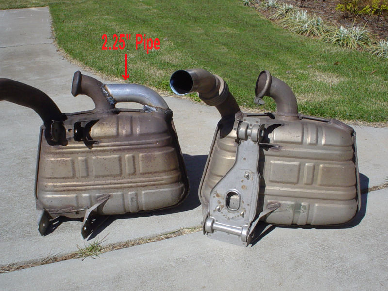

I just replaced my Fabspeed muffler and installed PSE (hacked) system. Sound better than Fabspeed. I should have done this long ago and not waste $$ on Fabspeed.

I keep hearing about this PSE Mod. I've searched this site and renntech and found nothing of substance. Did you modify a stock 996 exhaust or 996 porsche sport exhaust? Is there a DIY? Any help would be appreciated.

I modified the stock 996 cans. I was EZ to do, the local muffler shop charged me $120 for both cans. If you do it, get the 02-04 996 cans they give you a loud sound than 99-01 996 cans.
Tell the muffler shop that you want a 2.25 in pipe either stainless steel or Alumize pipe. Ask them to cut a 2.25 in. hole at the outlet pipe and one at the can nipple. That's it. Look at the attached pic. to get the idea.

i did the same mod on my 02 996 (with a 3.6L catback). Sound is a little louder but nothing to write home about compared to stock. i am amongst the minority though, most ppl love the PSE mod. I am just not convinced it's worth the hassle. I spent only $150 though to add the pipe.

I did it too. It doesn't exactly sound like the PSE, but about 70-80%. It only cost me about $60. My friend help me cut and weld it.

Did the same mod here, about 70-80% of the real thing but for $250 including install, it's well worth it.
