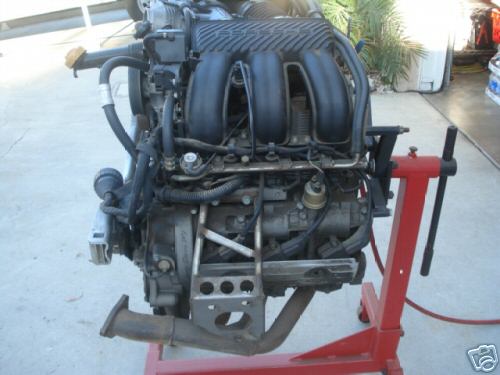

The 1st pic is your temp sensor that triggers your fans up front. It goes in between the the 1st and 2nd air distrib tube. You have 3 on each side. If you have a PET you can find the diagram. Don't have it handy.
I can't tell where the 2nd picture is. Need more surroundings to get my bearings.. maybe somebody else can chime in here?

Found ya a picture. It is the thing at the top sticking up between the two air distrib tubes. So directly below the O in PORSCHE

That second connector is normally off, I believe it is a spare and is used for some other options.
heres mine on my SC 3.4, during installation... its part of the rear harnesses
