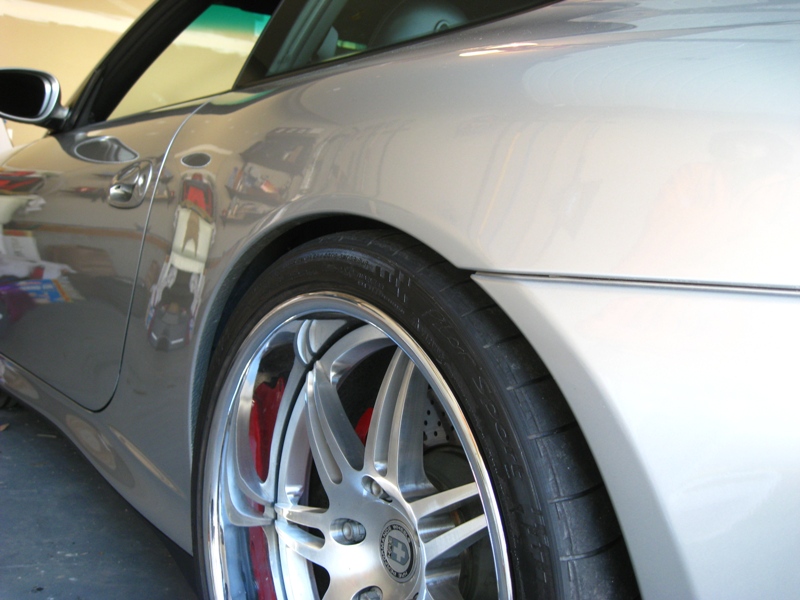

I put the wheels on and the rear tires stick out so much that it rub and the fender cut into the side wall of the tires. What went wrong?

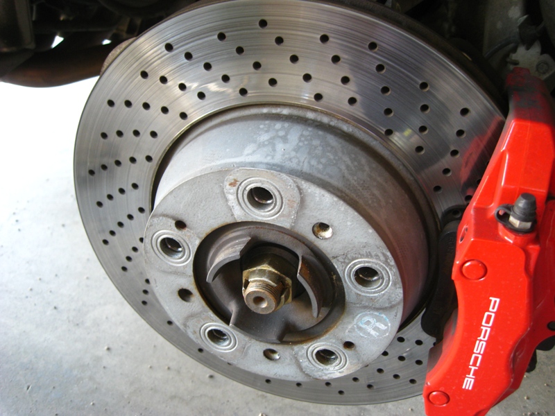

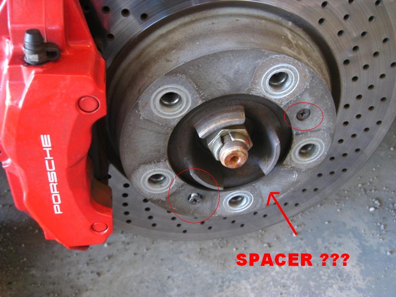

I have attached some pics, not sure if the grey part is the spacer, I tried taking it off, but is seems to be connected to the brake disk.

what about the grey part on the hub?
it is only held on by 2 screws? just that it seems to be connected to the brake disk in the back. do you think that is the spacer?

I certainly don't have an intelligent answer beyond the offset's being off. On pic 3 - measure the distance from the center to the floor - make sure they are the same. My dad ran 315s on his 997 C4S on 19s so width is not the issue... [noted below: oops ]

Did you ever see pics of them on the Turbo? Some people buy their wheels that way. They may have had a very aggressive offset. You dont have spacers..thats you hub...dont remove that. Whats the width of the rim and offset? That will tell you if there is a problem. Also is your car lowered? Have you had the camber adjusted on the rear of your car? It could be that IF the Turbo was lowered and had an aggressive camber that the tires would not have rubbed on that car, while your car ha a more conservative suspension setup and thus it rubs.....

Here's a pic of them on a Turbo and they are more recessed

first thing you must do is find out the offset/backspacing of those wheels then we can determine if it should or should not work on your c4s. it's clearly an offset/backspacing issue here. the screws that you circled is what holds the hub/rotor. DO NOT take that off unless you're swapping rotors.
