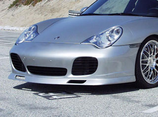

Old Oct 30, 2009 | 08:32 PM
Katmanz's Avatar
Joined: Jan 2009
Posts: 130
From: Milton
Katmanz is infamous around these parts
Is this the lip you guys are talking about?
