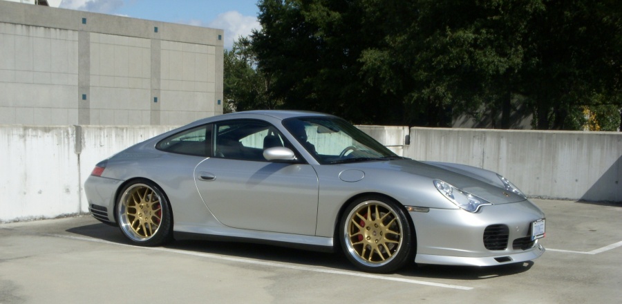

I have 9's on for about 4 years now. I drive her everyday, Sunny, Rain, Snow or Ice... I like them. If i had known i would have gotten H&R's coz they go a lot Lower, how i like it... I wish these Went lower... My car is preety Slammed, you cant put a Finger thru any Fender but i wanted the "Tuck" look, but not with PSS9's...
Do i Scrape? if im not Carefull yes, but i am good at Tri-Poding... I had to Tighten them one Notch up this Summer because they were going Soft on me (normal)... All good now... I was running 7R & 5F for 4 Years but now its at 6R & 4F feels Firm Again...
