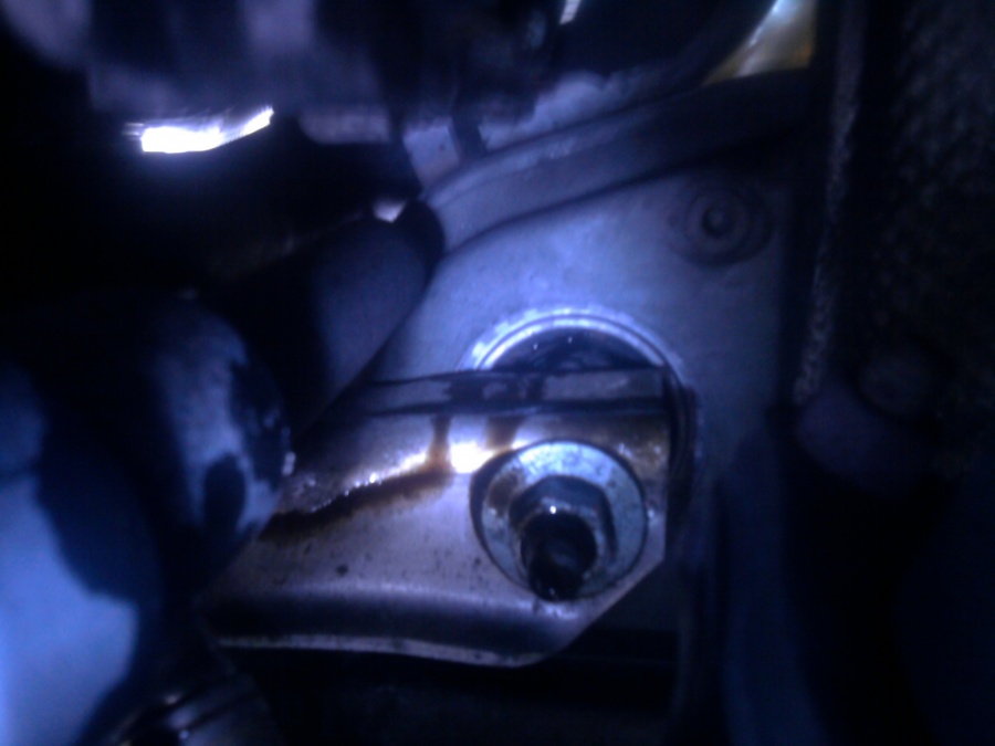

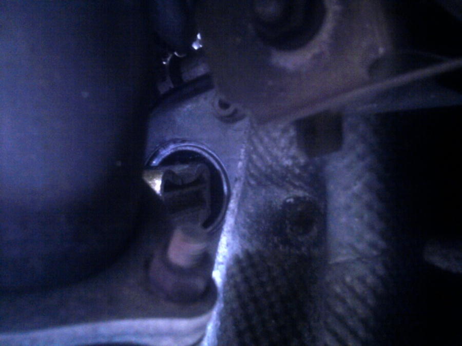

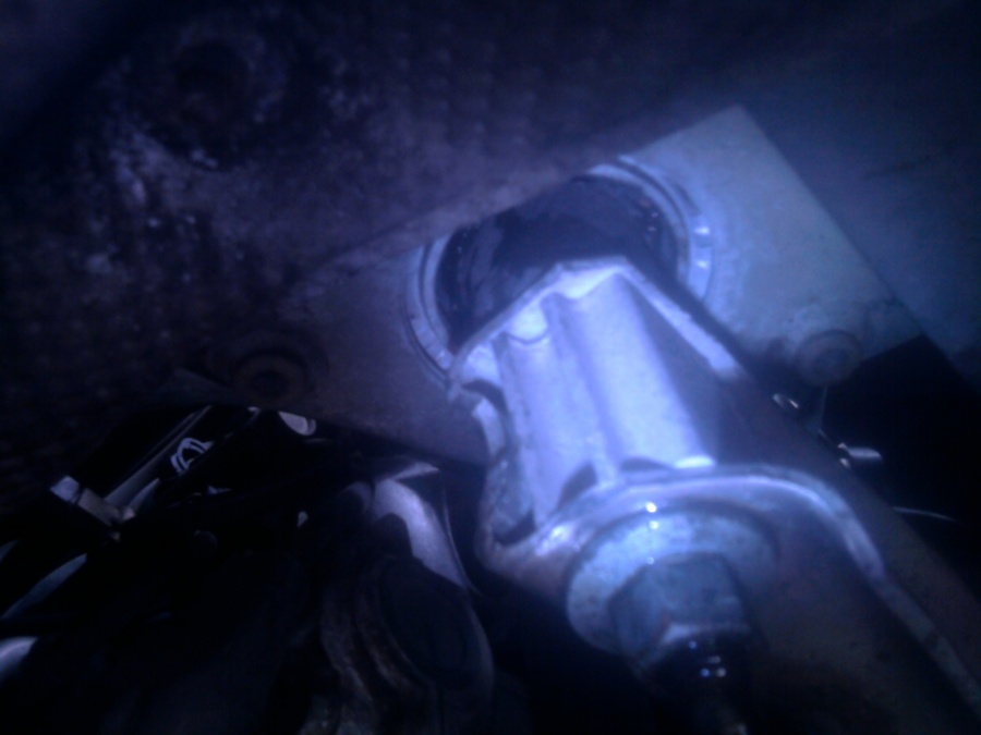

Swapping out some by-passes, i was following the DIY and lifted the car from the motor... I almost had the right side muffler out so i lifted a bit more, maybe a total of 6 ".. On the passenger side, the engine mount begun to poor black fluid... in pics... so i finished the job, removed the lift and used the driver side jack position to remove other muffler... Once i had removed the jack from under engine no leak what so ever (even while i had lifted the driver rear tire).. what can it be, is it safe to drive?

Sounds like you ruptured a motor mount and it will have to be replaced.
Why not use the jack points on the rear side?

You can....but if your motor mounts are old, this is what can happen.
I'd drive it easy to the repair shop.

Yup, sounds like a blown engine mount.
Yes you can drive.
Should replace as soon a convenient.
1. Can get used from DC auto.
2. Can try solid: http://www.wevo.com/Products/Chassis...gineMounts.htm
3. Can use 964 RS Mounts:
(2) 964-375-043-81 Mounts
(4) 901-305-311-00 Wahsers
(4) 999-025-074-01 Washers
(2) 12x1.5x125 Bolts

spoke to mechanic, definetly motor mount... i found a set for 140$ Both... he will charge 1 hour labor... worse thing about it, as soon as i heard the car with muffler by-pass, i got back under and got the OEM back on....
2 hours and a mount later..
ALL FOR NOTHING!
