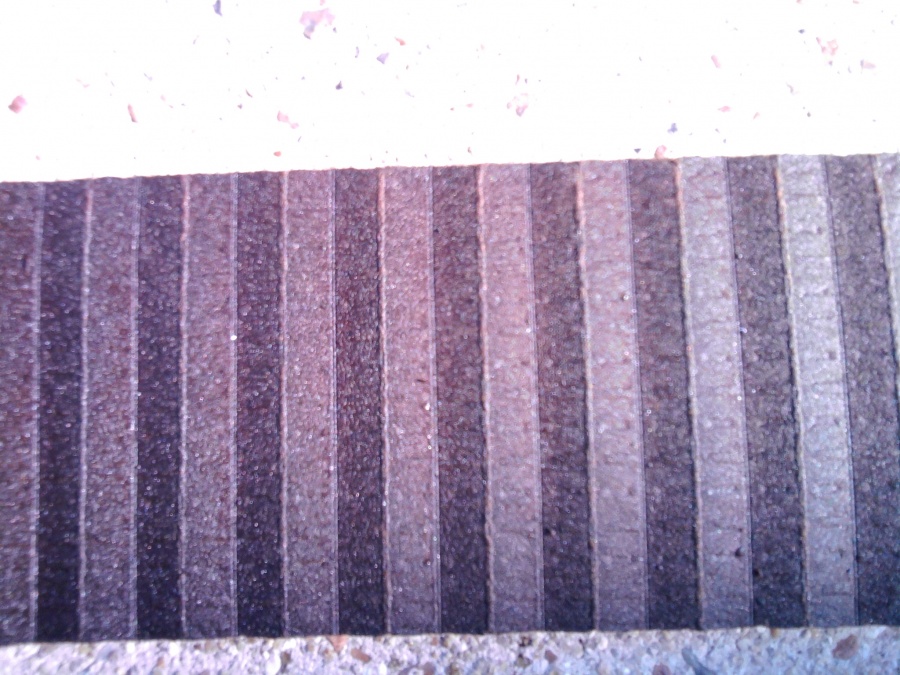

So i change oil and open the filter, metal specs...
History is, 5k miles ago a used engine (bearing replaced) was installed, engine had 43000 miles..... According to my independent mechanic (which performed the engine install) the engine was a rebuild (porsche), he thinks its not a problem (he has 30 years experience), any way i have seen at the shop some of the methal residue that comes from an IMS failure (those are chunks, these are microns) but there are a lot of them in the filter....
Pic makes it hard to see, overall i think maybe 40-50 pencil point size flakes...
sorry for the pic quality
OPINIONS?

let me add that these are very fine particles or fillings of metal and bits of gasket sealant...

I'm surprised nobody has responded yet...I'm no expert but from other similar threads people usually recommend sending an oil sample out to be analyzed. I know some small particles are to be expected so if I were you I'd send the oil out and run by a trusted local independent mech for his assessment of the particles in your filter.

00 3.4, manual... Indipendent mech sais it is fairly comon to find particles in filter. Most of the particles were visible only the 2nd day when all oil had dropped out. Since the engine had been remanufactured, he believes those are residues of a break in period. He showed me the "shavigs" from IMS failure. He is scheptical this could be IMS, because when he installed this engine 43k miles (USED) it was a remanufactured and had the LME bearing installed ( he verified before placing in car). In 300 miles we will check filter again, insert magnetic oil plug and send to get oil analized. One more thing, i can hear no noises what so ever from car at cold start, or anything else for that mater.
Is anyone else getting these specs in engine... ?

No i did not. after oil + filter change, i drove the car 1000 miles, last week my mech and i pulled the filter and initially nothing, once the filter rested in a rag a few hours, we saw 4-5 particles. TSince they are so small and the number was drammatically lower, he sais its nothing to worry about. He has showed me probable 10 different signs of internal problems ( methal particles, shavings, pearled junk, plastics and so on, from other costumers cars he had saved). BTW he has been a porsche mech for over 40 years, many of which at dealers.

Boy i can feel your pain! When i drove it for those 1000k... I too could not rest well about it. My tech told me that when he takes engines apart, he finds a lot of debries in the bottom of engine, in many places... And you are right about the IMS being only one of possible failures... So for me, i will now drive it like i stole it, and enjoy it for what it was meant, change oil every 5k, and if something happens... Well i guess it was destined to happen.
