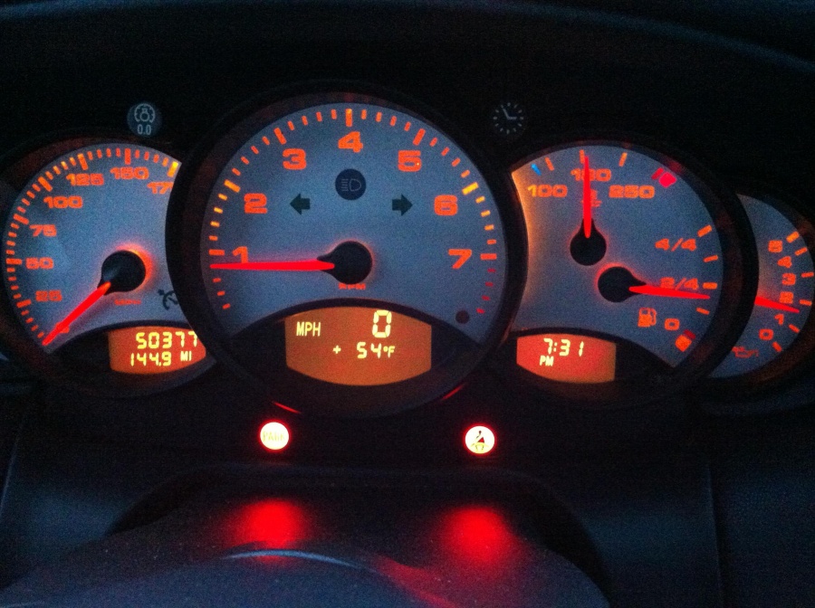

All my previous cars have always ran with the needle right in the middle. My 996 is always a bit passed the middle, is this normal?

Mine runs right between the 8 and the 0 of the 180 degree mark.

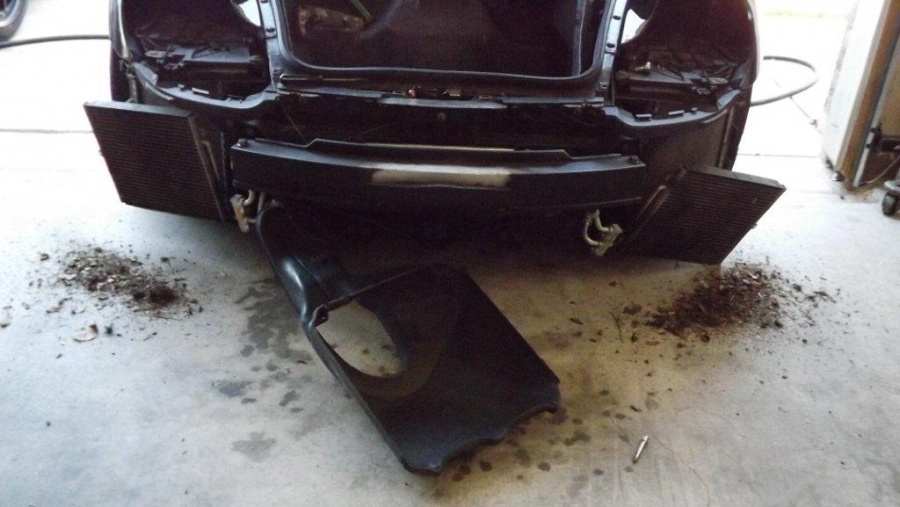

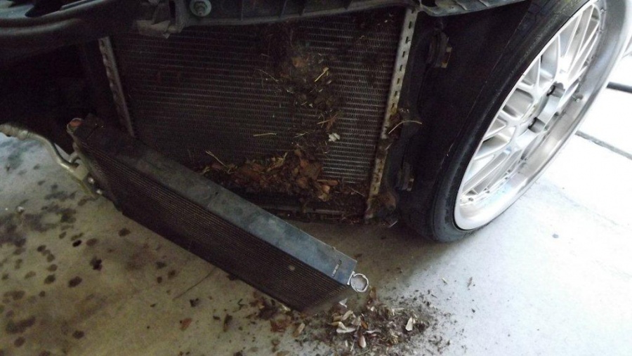

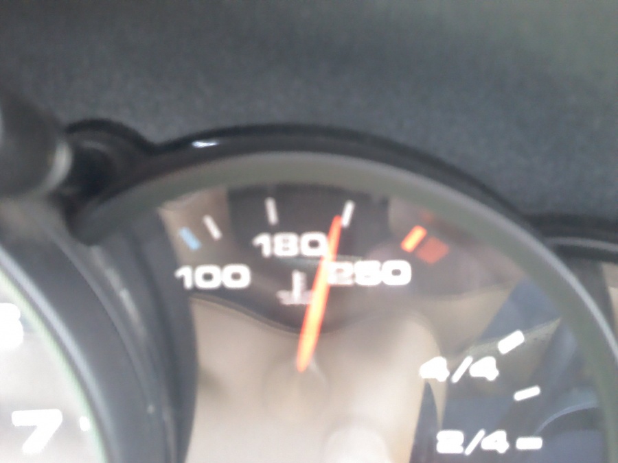

Mine was running on the line after 180... you know.... the one before the red zone! so im gessing 220??? i cleaned out my radiators and installed the 3rd center radiator last week and it now runs between the 8 and 0. What a relief! last smmer was brutal and i stressed everytime i drove it!
All is good now!

Sergio, are you sure your radiator fans are operative? You may want to check the fans and/or the relays. That looks pretty hot...

Yeah Dennis, they are working. This was before the radiator cleaning. They were nearly 50% covered! i couldnt even get water to pass through the fins! i spent about 30 minutes n each side using a horse hair bruch and high pressure water. All is good now... running between the 8 and 0.

Sounds good. Mine were pretty crazy when I cleaned them out too. Lots of cigarette butts, leaves and grime, a piece of wood and the label from an Aquafina bottled water. It was interesting...

What this doesnt show are the foam peanuts i found! incredible.
