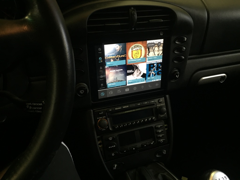

I ended up changing it up and doing a full install.

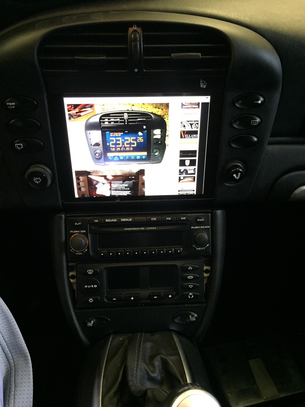

Hello to all of you from Italy and thank for this wonderful thread. My installer is about to finish to install the Ipad mini in my '99 Porsche 996 Cabrio. Unfortunately, he called me few minutes ago to tell me that no USB radio have power enough to charge the Ipad mini 2 RETINA, and that I should buy a Ipad mini 1 to have it charged while in use.
What do you think about that? Any suggestion?
Thank you in advance!
Stefano
Old Aug 1, 2015 | 02:03 PM
  #345
Stebuga's Avatar
Joined: Jul 2015
Posts: 9
From: Milano
Stebuga is infamous around these parts
At last I have the mini Ipad installed on my baby ! By now, and until I do not solve the problem of major charging request of retina display, I have installed an old JVC connected to earphone line out of Ipad .
I hope to find soon a usb car radio that can provide power enough!
