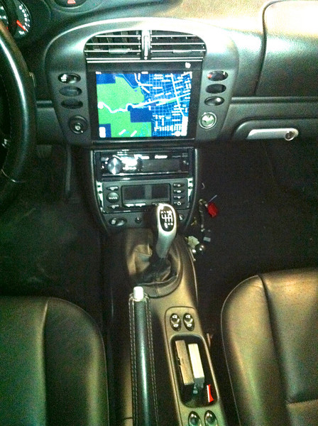

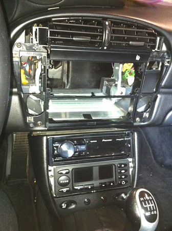

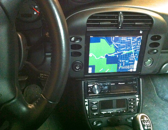

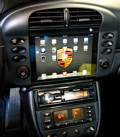

One of the things I've had been waiting on was a working jailbreak for the mini with IOS 6.1., which was recently released. The thing I really wanted jailbreak for was to eliminate the 'lock' slider and have the mini immediately go live to the last app in use when the ignition is turned on, and immediately go to sleep when the ignition is turned off, just like it works with the smart cover. Simple enough, but impossible to accomplish without jailbreaking the device!
The jailbreak should also allow me to use the less-expensive generic OBD2 bluetooth devices to feed data to Rev, harrys lap timer, etc. (still testing this)

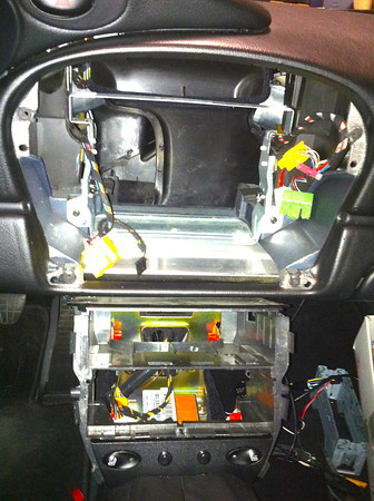

I just got out to the garage to do a final test fit. Everything seems to fit perfectly, though I still need to purchase the lower HVAC trim bezel (996.552.339.00-01C).
Sorry for the crappy garage-at-night photos. I'll get some better pictures once everything is finished and cleaned up, but this will give you the general idea...

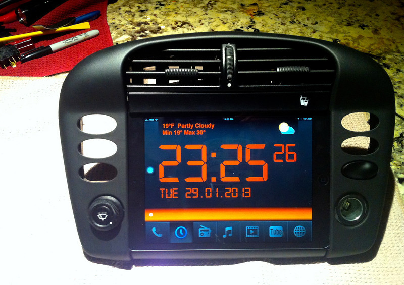

Cup holder could be retained...

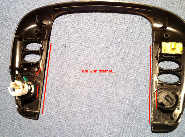

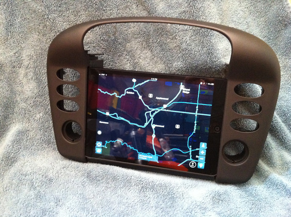

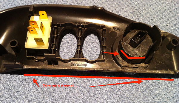

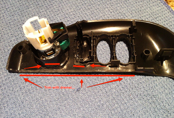

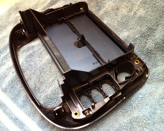

More details on the horseshoe bezel modifications... *After modifying, the iPad is sandwiched tightly between the front bezel and the radio support bracket.

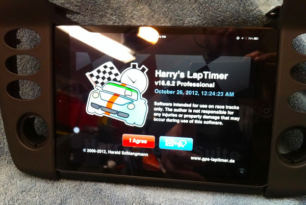

  • Harry's Lap Timer: This is really a dedicated track road course race track application, but is an great application. It does have some functionality that is useful off the track as well, including reading/displaying OBD2 parameters if you have a bluetooth or wifi OBD2 connection.

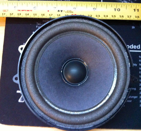

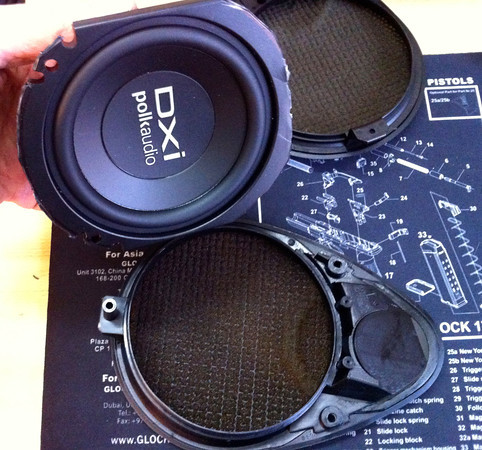

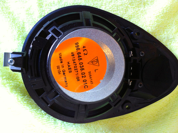

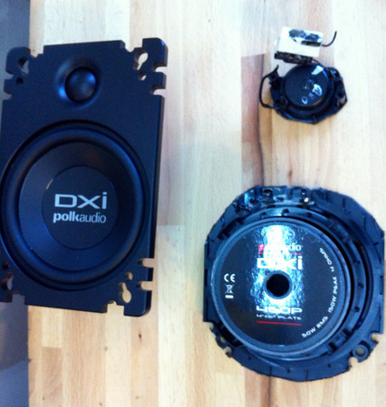

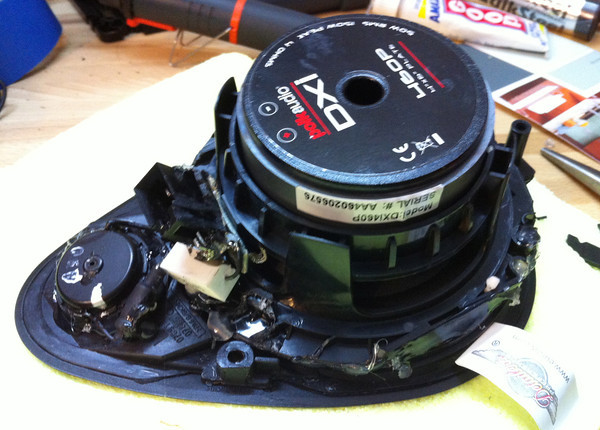

I had the non-bose stereo system. Same (crappy) Becker CD head unit, but no MOST connected amp, no funky subwoofer, and no odd-ball 2 ohm speakers to deal with. If you do have a Bose system, I'd suggest dumping the amp and replacing the speakers with even some inexpensive conventional 4-ohm speakers. Drive them off the head unit or add an amp if you want. Some people use the bose speakers and add an amp that can handle their very low 2-ohm impedance, but my guess is that the sound quality isn't worth the effort.
The stock speaker wires ran right to to an ISO plug behind the stock radio, and I just used a simple ISO wiring harness adapter so I didn't have to cut any factory wiring.
I'm driving the speakers directly from the Pioneer with no external amp at this time. I could also the stock speakers, but I chose to replace them with some upgraded speakers. I used Polk Audio DXi460p 4"x6" plate 2-way car speakers and modified them to mount to the factory grills. They don't sound bad, apart from the obvious lack of bass, but I think I might try some new ideas and possibly an additional amp as well... If you have the bose system, you probably can fit larger 6" separates into the door speaker pockets. My car only has the dash and rear side speakers and I didn't want to add anything into the doors.
Here are a few pics of the original speakers and how I fitted the polks to the OEM dash and rear side speaker grills...
