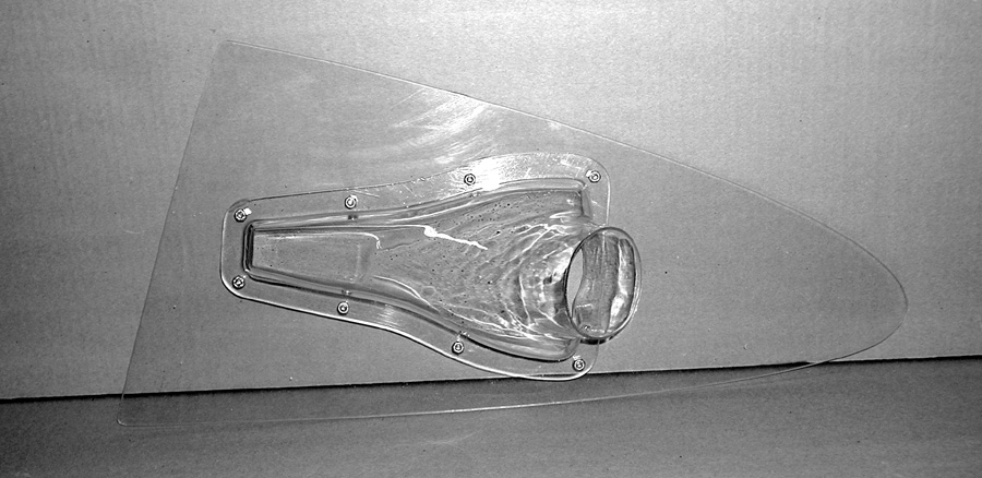

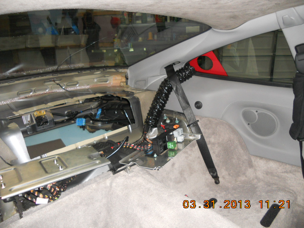

Thought I'd Let ya'll know about a project I'm in progress on. I'm installing an LS3 480hp GM motor in the rear of my 996. I've also cut an access panel in the rear of the passenger conpartment for engine access. Now here's where I'd like some imput. I've also decided to build a cold air intake that would use the rear windows with a 2 1/2 hole cut in the aft part of window with a scoop on the outside. Has ANYONE done this in the past.

Question is CAN a hole be cut without removing window?

Not sure about cutting hole in the glass, but you might want to consider replacing the glass with Lexan. Then you could include a NACA duct to funnel the air efficiently.
I'm sure there are issues, maybe you could get air from under the car instead?
Good luck with the project.

That's the kind of help I was looking for, I couldn't think of what they called the NACA Scoops, Thanks much. And that might be a better idea to replace the whole window but I was maybe wanting to keep the visability by only using the aft 8" or so for the scoop. Still Brainstorming

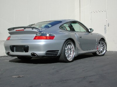

How about installing the turbo vents on the rear fenders and ducting air that way.
This is a wide body C4S and I can't for the life of me figure out HOW they route the air on the Turbos. This is my first Porsche experience and I've never seen a Turbo in person. And I'm not sure about cutting rear fenders.
There is a "kit" available for nonturbo 996's
A few on this forum have installed the side scoops...i believe 1 person has done it to supply "cold air" to his supercharger

GT-Racing.com sell the Lexan windows with the NACA duct.
Nice!
Looks like they also sell a fiberglass turbo-style rear bumper. Might be a bit easier to route the intake air then from inside the cabin?

Talked to the glass experts and they say no way to cut a hole in tempered glass. Thinking about replacing with the Polycarbonate and adding my own scoop/vent. Thanks for the GT Racing link, that helped alot. Now do I try and remove the rear windows myself? Never messed with windows before, will have to do some research. I'm also wondering about the noise factor and think I'll give it a try and even if it doesn't work I can use the scoops to bring some cooler air to the engine bay.

That's because the side vents are where the innercoolers are, the air intak is in the rear and sucks through the boot deck vents.
previous note was right. you dont have the turbo side scoops on a C$S because you dont need them. Why dont you get a turbo and just take out the engine? or, I'm pretty sure you can get Porsche turbo body parts, rear side panels, with the scoops already cut out. aspiration for the v8 will be a problem. I liked the suggestion of putting in a bottom scoop like the Mustang P51 fighters. But them, same as the Mustangs, your pretty vulnerable from underneath. I do think your best bet is to simply get the turbo side panels and convert the turbo intercooler scoops to your air intake. Course then the car would look like a turbo, not a C$S. I'd actually stay away from the window scoops, might spoil the lines of the car. But its a cool project, and I'll bet you get it all worked out ok. The car will surely be a screamer. What are you doing to beef up the rear suspension, by the way? Good luck with this.
