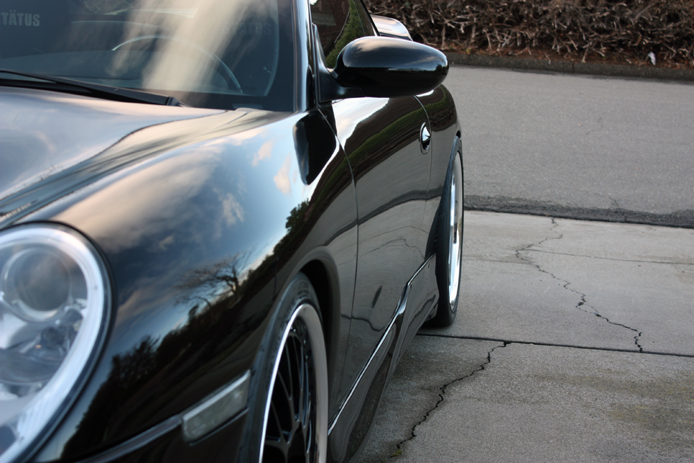

I've run 19x11 +51 on my 996 C2 which measures out to be 2mm more aggressive than running 18x10 +40. However I would not recommend going any lower than a +40 with a 10" wide wheel.
And that doesn't rub for you?
-What's the tire size?
-What suspension are you running?
-How much camber is that?
-Are the fenders rolled?
Looks mighty tight...
Old Dec 8, 2013 | 11:14 AM
Its Kip's Avatar
Joined: Oct 2011
Posts: 95
From: Sacramento
Its Kip is infamous around these parts
No rubbing at all with those wheels. This is the limit you can run without starting to use narrower tires.
- 295/30/19
- Bilstein PSS9
- Factory camber settings
- Yes fenders are rolled
