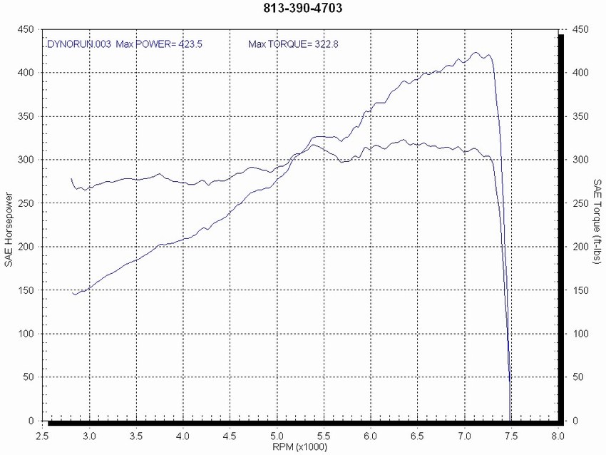

i do have some updates on the hoses. the test fits were complete on the silicone hoses about a month ago, and they should be ready any time now.
in an effort to do some cpr on the thread , here's my latest dyno run with the headers.
