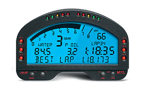

i am real interested what the SC is boosting with that pulley. i'm getting a boost sensor for my MXL pista so i need you guys to install it along with the snow stuff. just waiting on parts

hey d dog,
the silicon hoses replace all the roto-molded parts?
BTW, looking good with the gauges. the AiM MXL pista i am getting is more of a race track data logger but will also do boost, EGT, AFR. think i'll just monitor my AFR thru my OBDII scanner instead.

kewl, i'll be on the lookout for the new hoses.
not sure if the scanner does wide band. i'll have to check.
i think i am making more than 6PSI but i want to confirm.
the aim unit is a true track data acquisition system less of an engine tuning tool. it's more of a driver tool.
-RMP
-speed
-gear position - calculated or though potentiometer
-programmable shift lights.
-lateral and longitudinal G's
-lap times/ split times/ presumptive lap times
-additional speed sensor (to calculate wheels slip front/back, shock settings....
-GPS
-programmable alarms
-customizable display/dash
-odometer
-8MB of memory
-has 8 analog channels for various sensors:
-throttle position
-brake position
-steering position
-pressures - boost, oil pressure
-temps - oil, water, ambient, engine, EGT, intake
-AFR
-can make your own programmable sensors
-data download to a computer.
-though the software - plotting any and all of the above including, track drawing/plotting, g-sum graphs...
it's a very comprehensive data logger plus dash. i'm initially setting it up for RPM, speed, oil pressure, water temp, intake manifold boost, post intercooler intake temps and setting alarms for oil pressure and water temp and of course lap times. later i'll add throttle/steering/brake position.
ya it's not 500 bucks. it's 1600+ but it does a helluva lot more and since i've become a track junkie i am convincing myself that i need all this stuff . hey, company stock is up and i wanted to reward myself .

wow, that's pretty cool. lots of bells and whistles i like it.
why set it up for speed, rpm, water temp, and oil pressure since you already have that on your stock dash? wouldn't it be more helpful to put stuff on there you can't monitor?
where are you going to put that? it'd be slick if you could fiberglass over the stock dash (something removeable) and flush that in where the dash would normally be.
why do you think you're making more than 6 psi? do you have an extra small pulley on there? careful with that if you are. i'm not sure the software really has the flexibility to maintain the proper parameters with the higher boost levels. could be experiencing a lot more wear and tear for an extra 15-20 hp. especially when your talking extended beatings at the track

i am mounting it as a temporary dash in front of the oem dash. mine is not a permanent install, although it can easily be. you see them all the time on cup cars. the RPM graph is standard, so is speed so you really have no choice. it's easier to monitor especially when the backlight is on. instead of looking down close to the radio, it's in my face. i can set up alarms for water temp, pressure etc., and i can get a numerical value rather than "it's between 180 and 250". kinda vague isn't it? i have 8 channels for sensors, rpm and speed do not count. remember this is a data logger not just a dash so not only can i monitor as i am driving i can see the effects of Gs in a turn on oil pressure, for instance, after downloading the data to my laptop.
i'll post pics when the dash is finally on.
the programming does have the flexibility, why would you think otherwise,just a hunch ? do you really think it is programmed to the max without any headroom? i'm sure it is a wear issue with EVO so they probably de-tuned the kits. with all the track miles i have done and will be doing, i expect to rebuild the engine at 100K (i am at 80K) with beefed up parts anyway. gonna start doing the homework. maybe when the time comes todd will have the parts already.

Cool I like the look of it. I ended up getting the PLX kit for my 930. See ya soon!

you'll have to keep us posted on what your boost turned out to be. nope, not a hunch. have had several conversations with EVO, my installer, and some tuners on this very topic of running more boost. you probably won't be able maintain stock AF ratios running much higher than normal boost with the current software. could cause problems for you down the road, but sounds like you're ready for a rebuilid anyway
that logger you bought sounds awesome. if i was doing any track time, sounds like that would be the unit to get. mine will only datalog the basics. i could see where that other stuff would come in handy if you were trying to shave lap times down some.
post up your boost and AF levels when you get that logger hooked up. if you can maintain stock AF ratios with higher than normal boost, i may consider going that route myself. although right now my car is running really well (knock on wood) and making a lot of power. not sure i want to risk it for another 15 or so HP.
