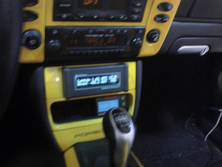

Gauges are in. Pretty cool. Here's a couple pics....

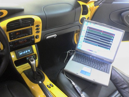

here's another....

I took them with a camera phone, so they're a little blurry but you get the idea.
The datalogging feature is very cool. I'm still trying to figure out how all this stuff works, but so far so good.
One thing I have noticed is that the gauges are so sensitive that you really need to review the data on the laptop to see what's going on. The numbers move very quickly on the in car display. It's good for general reading, but if you want details, got to break out the laptop.
Took it out for a short run today. Held it open in 3rd gear from 3.5K till redline. Saw a max boost of 5 psi, 12.3 for A/F, and an EGT of around 1050. I know 3rd gear is a little short to be measuring full boost, but there was traiffic and I didn't have time to get on the highway. I'm sure a 4th or 5th gear run would yield much higher boost (probably at least 5.5). I did see a spike of 5.7 on decelleration, but I'm sure that's a fluke.
This thing measures TPS as well. One thing I noticed is that when I floor it, it goes to 100% and then immediatley drops to 98%. I'm assuming that's the ECU doing that, cause my foot stays planted the whole time.

Hey Dog... Very cool indeed. The 3.6L's boost exactly where you're supposed to be. AFR's are perfect (Not suprised since Garret's tuned it). I'm scared to see what a 3.4L with NO E-gas *man I like it that way- and the extra small pulley boosts
