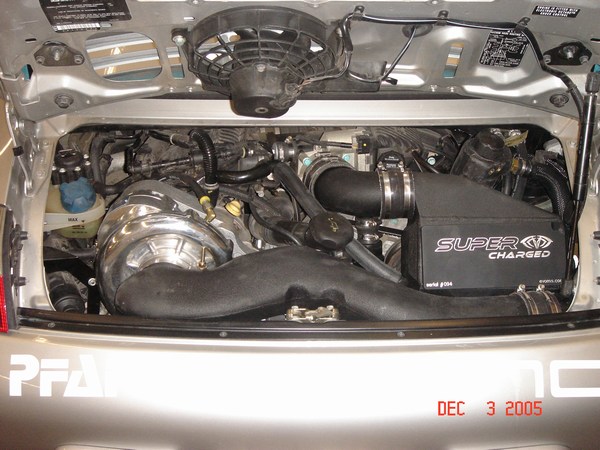

Originally posted by deputydog95
this is the boost sensor i'm using with the zeitronix gauge:
Boost sensor is a 3.5 Bar absolute MAP sensor. The Zt-2's high resolution boost input in conjunction with a Zeitronix Boost Sensor is more accurate than most boost gauges.
i talked to my installer. he said it's hooked up to a vacuum line after the thottle body and before the check valve. he said the digital gauges, like the one in TT, are much more sensitive and will tend to bounce around more.
i'll have them get some pics before I pick it up. not much to see under the car. Just the sensor bungs. the data log connection is in the center console cubby. the brain is right behind there. the display is going on top of the top cubby under the radio.
i definatley plan to do some data logging when i get it back so i can set a baseline. that way i can make comparisons as time goes on.
i spoke to evo today. the silicone boost hoses should be ready any time now. the bottom one is set, and the top is almost done. the top aluminum one is also almost ready, but not exactly recommended due to the heat retention. nice bling factor though

Checkvalve
Originally posted by 1999Porsche911
Hey Dog: What check valve are you talking about on the vacuum line? There should be no check valve between the manifold and MAP sensor or gauge. If your talking about a variance in boost reading while partially accelerating, then that is normal in all cars and is reflecting what IS and is not inaccurate. Remember that the engine is a pump and will fight between vacuum and boost at certain throttle positions. However, if you accelerate at WOT, there should be a jump in boost immediatley and no fallback at all with a steady increase in boost until you go less than WOT. If the gauge reflects anything other than an increase in boost while at WOT, look for a leak somewhere. Even the cheapest boost gauge, which may not display the correct absolute pressure, will not jump around but display a steady increase. The only other cause of a drop in boost reading would be a slipping belt, which you would certainly hear, or a loose elctrical connection between the MAP and gauge. Is this a dial or digital gauge?
Deputy correct me if wrong just assuming here, but just before this check valve closest to the manifold distributor in the picture is where the pickup would tap into. The gauge he said he was using is digital- 1999Porsche911. Hope I did'nt step on his toes here.

Yep, it's a digital sensor and gauge. The car is still at the shop, but it looks like the spot mother has in his pic. I'm about 99 percent sure that it's placed before the check valve. My installer said the MAP sensor would more or less take the place of the check valve now, and that they would probably seal the check valve off. That's if I understood him correctly.
I haven't driven the car yet, so I'm not really sure what it's doing. My installer described it as hitting 4.5ish psi under full throttle, and then immediatley dropping off. I'm assuming reading of less than 6psi is due to some loss with the intercooler plumbing, etc...
