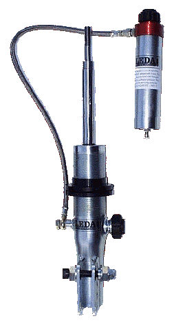

Another shock to try is Leda. I had a set of remote resevoir, double adjustable, nitrogen filled on my 944Turbo. They were the best shocks I've ever driven on. I think they make a set for the 996. Carl Poetle at Racers Edge is the man - call him if you're going to consider them. He'll make sure you get the right stuff.

I went with the Ledas on my 944s2 and loved them. I can put you in contact with Karl if you want to look into them.

Anybody done a set of Leda's on a 996? I just want to make sure whatever I get fits right and doesn't make any noise.
Is Leda Swedish? For some reason I thought Leda was related to Ohlins (motorcycle suspension gurus).
