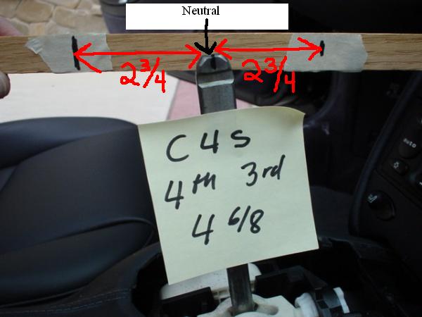

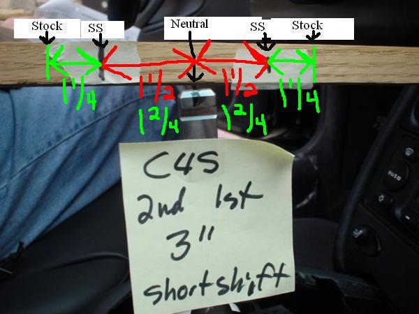

Jeff, I see by the picture and the measurements that the in car SS does reduce the throws into all of the gears, hope this helps.
The stock shifter moves 2 3/4 of an inch in each way to select the next gear as pictured.

But with the SS the throw reduces to 1 1/2 inch in both directions. Thus leaving 1 1/4 of an inch in each direction of travel reduced by the SS. As pictured.

So in conclusion the in car SS does reduce the shift in ever direction, not just into the upper gear, i.e. 1-3 and 5.

Yes, the throw is reduced in all gears and that is why I could not understand why some said it was for only certain gears or why some said it should be combined with the transmission mounted unit.
When you see the pictures of the lever in the middle of the 2 black lines on the tape then the lever is in neutral. I would put it in first, take a picture. Then neutral, take a picture. Then second, take a picture. Same thing for 3-4. Did this on the oem shift then again after the Porsche short shift was installed. Could not post all the pictures at the same time as there is a limit.
There is no need to install a unit on the transmission as there will already be a reduction in all gears when the lever style short shifter is in.
I will do the same before and after measurements when we put in the B&M unit that bolts to the transmission. The only issue there is that it has 3 settings. Jeff
