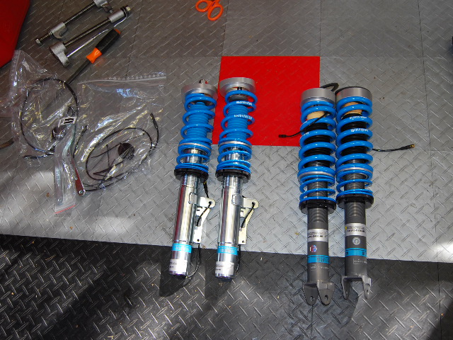

Next, it was time to tackle the nice goodies Mike from AWE sent me from Bilstein

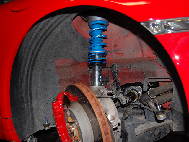

Really a nice looking set of hardware. First I measured the old ride height of my car with the Techart springs, and also marked the strut hat nuts locations in the front to give me an idea where I would want to set the car.

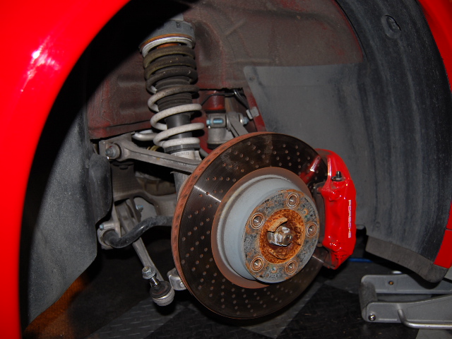

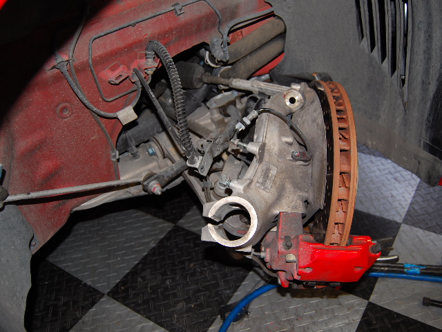

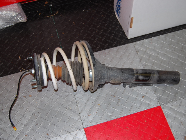

Next, pulled off the fronts

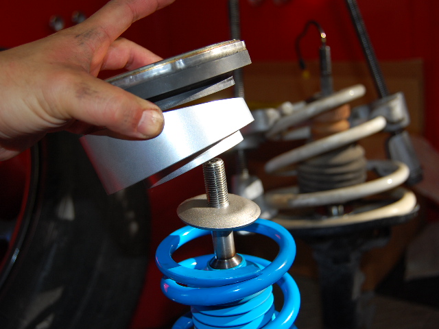

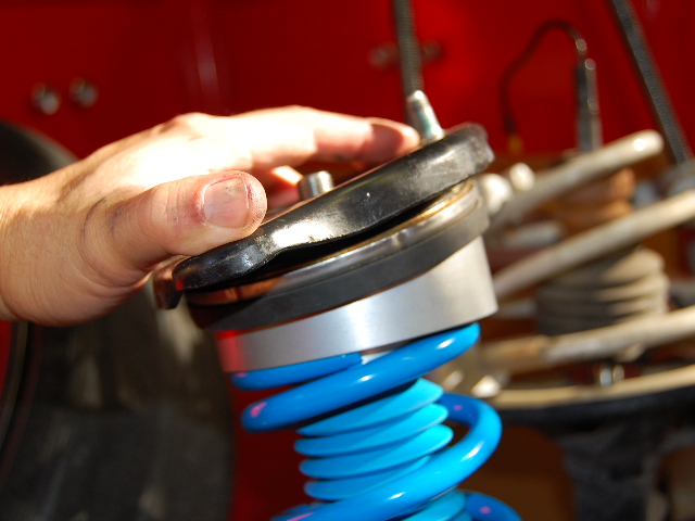

Reassembled the hats to the new Bilsteins.

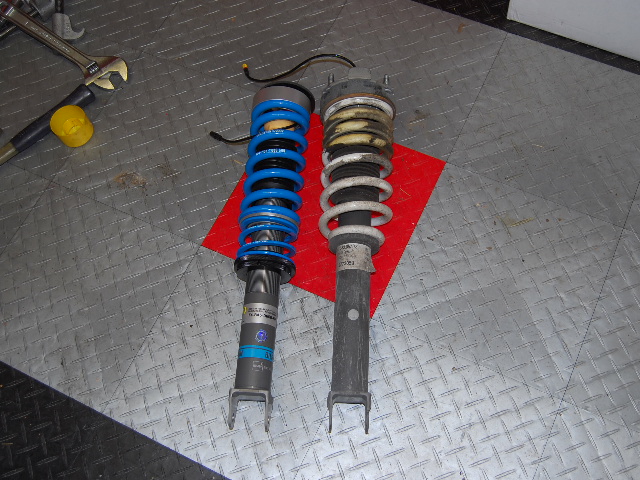

Notice how primitive the stock suspension looks compared to the PSS10 unit.
Back installed and tightened up.

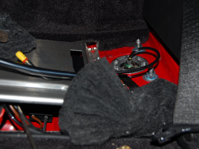

Moved on to the rear, which is a simpler job. Removing the rear strut:
Unbolting the rear hats from the inside

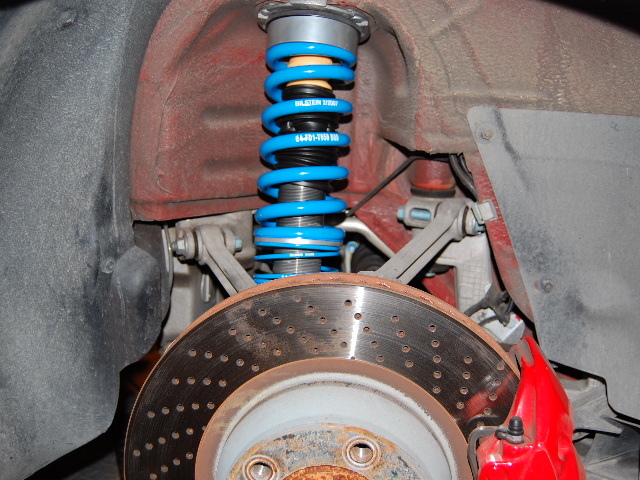

Comparing new Bilstein vs stock
New rear Bilstein installed
Impressions: went for a 5 minute drive, and have to say it is a very nice and compliant ride. No error lights, no harshness or chop, no noises whatsoever. The regular PASM mode feels tighter than before, but smoother at the same time. Sport mode is even better - tighter but without any harshness. If the Techart springs were an 8/10, these are a 9.5/10. I cannot wait to get the car aligned and on the track in 3 weeks!

I needed a spanner wrench (actually a 944 balance shaft pulley tool from 9xauto) and a OTC front end tool set. The spanner holds the washer of the front strut so you can unscrew the top nut. The front end tool set allows you to pop off the tie rod ball joint and the lower control arm ball joint. No domestic tie rod puller will fit in there

Also, can you confirm that we have to use a number of the stock parts (hat assemblies and rubber rings)? It seems that way in your pictures. Thanks,
Old Nov 12, 2007 | 03:40 PM
eclou's Avatar
Joined: Sep 2006
Posts: 3,028
From: Houston
Rep Power: 201
eclou Is a GOD !eclou Is a GOD !eclou Is a GOD !eclou Is a GOD !eclou Is a GOD !eclou Is a GOD !eclou Is a GOD !eclou Is a GOD !eclou Is a GOD !eclou Is a GOD !eclou Is a GOD !
yes the stock hats are re-used in the front. In the rear one washer is also re-used. Bilstein supplies new front sway links which are much beefier as well. The front sway links need to mount to the outboard side of the sway blade ends, vs inboard mounting for the stock links

How do the new rear hats look? Do they look just like stock or do they protrude a little?

the stock rear hats are re-used. Fitment should look just like stock

Thank you. I'm arguing with my installer over this! I'll also be sure to mention the other learning that the stock rings should be used instead of the Bilstein ones. Thanks again!
