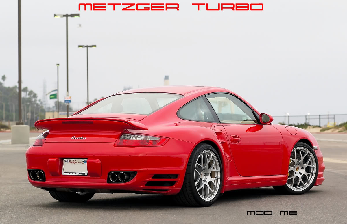

Latest shot of my Turbo baby. In case you don't already know, rating of PDK is rumored to be 790 NM/582 lbs-ft, meaning the new-engine 997.2 Turbo with PDK may not be mod friendly at all.
What is "metzgler turbo?"
"Metzger Turbo" was made up by me for fun. Thanks for the Porsche font, again. Am having great fun with it.
