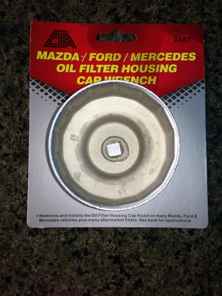

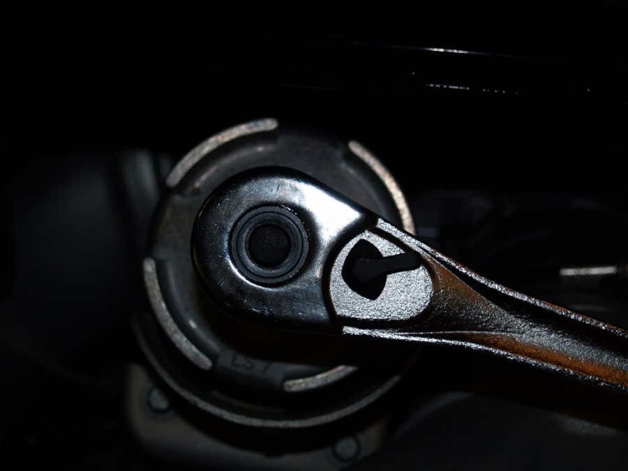

Great post, BBYWU. I recently got a 2004 996 Turbo, and this post helped tremendously with my first oil change! I looked for an oil filter wrench locally and found one at Pep Boys that fit perfectly. It is 76MM with 14 flats(flutes). They had a regular oil filter cap wrench, and they also one made specifically for an oil filter housing that is very similar to the one on the Porsche. The cap wrench for the housing is made for a Mazda, Ford or Mercedes, but fit the Porsche perfectly. I attached pics of the cap wrench. I also took Skeeter's advice and got the filter from Suncoast. They include all 4 crush rings for the turbo engine (crankcase, oil tank, and 2 turbo oil containers). For those of you who chose to drain the 2 turbo oil containers (I did), that takes an 8MM hex wrench.
