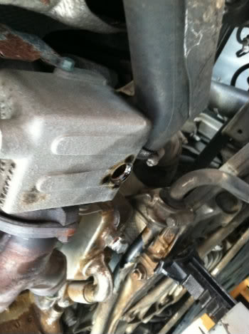

I did find the rear passenger side floor jack interfering with my oil catch pan so I had to jack the rear up from the passenger side jack point and remove that jack stand for the tank to drain properly into the basin. I also did the turbos (8mm hex), be sure to replace the crush washer and torque those to 22ft-lbs. The passenger side turbo drain location is shown for reference.
As a side note, if you find you have overfilled you can simply drain the crank case which is about 1qt. to avoid draining the tank. This amounts to about 3 ticks on the fill gage.
Thanks for the picture - very helpful...but this was in the very first post of this thread:
Note: 997s VTG turbochargers do not have drain bolts. On 996s, I typically don't bother draining the turbos as the volume is typically quite small.
Inconsistent info??

I'm not sure what you are referring to about inconsistent info, I was only stating I had chosen to drain the turbos and showed a picture. I was hoping it was helpful info as this thread is cross-posted on some 996TT oil changing threads.
I did say the picture was helpful...I was confused since I didn't realize you were talking abut a 996.

It's all good fellas - Even though this post was in the 997TT forum, it applies pretty much to all cars using the same engine block, including the GT3. The main differences are the drainage of the turbos.
BM33 - thanks for posting up the pics.
