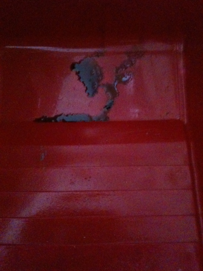

This is what leaked in 24 hours. Looks like oil to me!
It looks awfully dirty for fresh oil (and they should have changed the oil when they replaced the RMS).

Good point, it should look cleaner than that since its been replaced few days ago!
