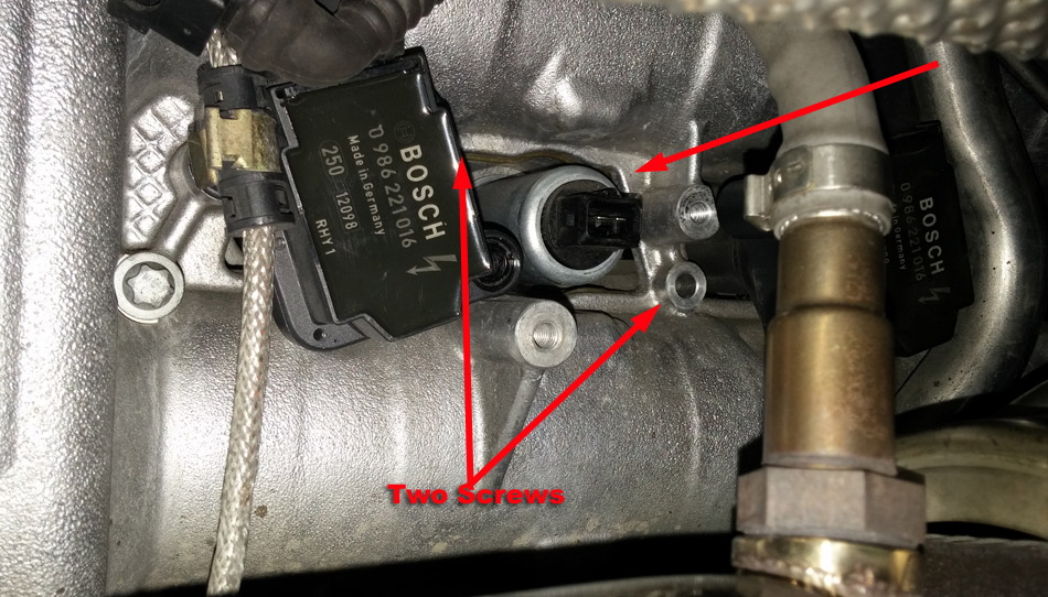

Originally Posted by function12
Did you swap the sensors yourself or did you have a shop do it?
I just swapped mine, and if you want to try it, you can get to them by following my Spark Plug DIY tutorial. I did it last weekend and maybe took an hour or so. You do not even need to lower the engine to get to them.
Good luck...
