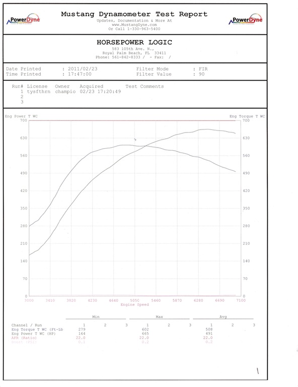

Lamboman.....gimme a call any time. I'd be happy to discuss different options with you.
Basically, if you're looking for easy bolt-on 700-800 CRANK HP....then there's a few easy options out there for you. If you want that power at the wheels, that requires a little more modification.
I just installed the package below on an '08 Turbo Cab, Tipronic, and we dyno'ed it at 610hp at the wheels this morning on pump gas. (http://www.championmotorsport.com/pr...-997t-1-pk.htm) It's the smaller of our two VTG packages, or 65mm turbos. We also have a 68mm turbo that will take you up to around 675 at the wheels (~840 crank) on a stock motor, and about 800 or so at the wheels (~1000 crank) on a built motor. Beyond that you'll need to explore non-VTG based options out there. Switzer and Proto would be the top two.
One thing that we do which is unlike many other tuners however is offer a true warranty that backs your Porsche CPO. You can find out some more about that here:
http://championmotorsportonline.com/...yagreement.pdf
Feel free to give me a call anytime if you have any questions.
