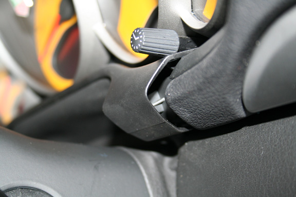

I have a fair amount of experience with changing the gauge cluster face.
It is not a very easy DIY, but it is do-able.
Removing the face gauge is not very difficult with the right tools - you do not have to remove the steering wheel, but doing so makes more space.
You have to pull out the plastic/leather trim under the speedometer, remove two torx screws below, then pull the speedometer straight out. Toughest part is pulling the speedometer out - it is held in with two speed clips. I used mini suction cups attached to the face of the speedometer to grab hold.

Instructions:
