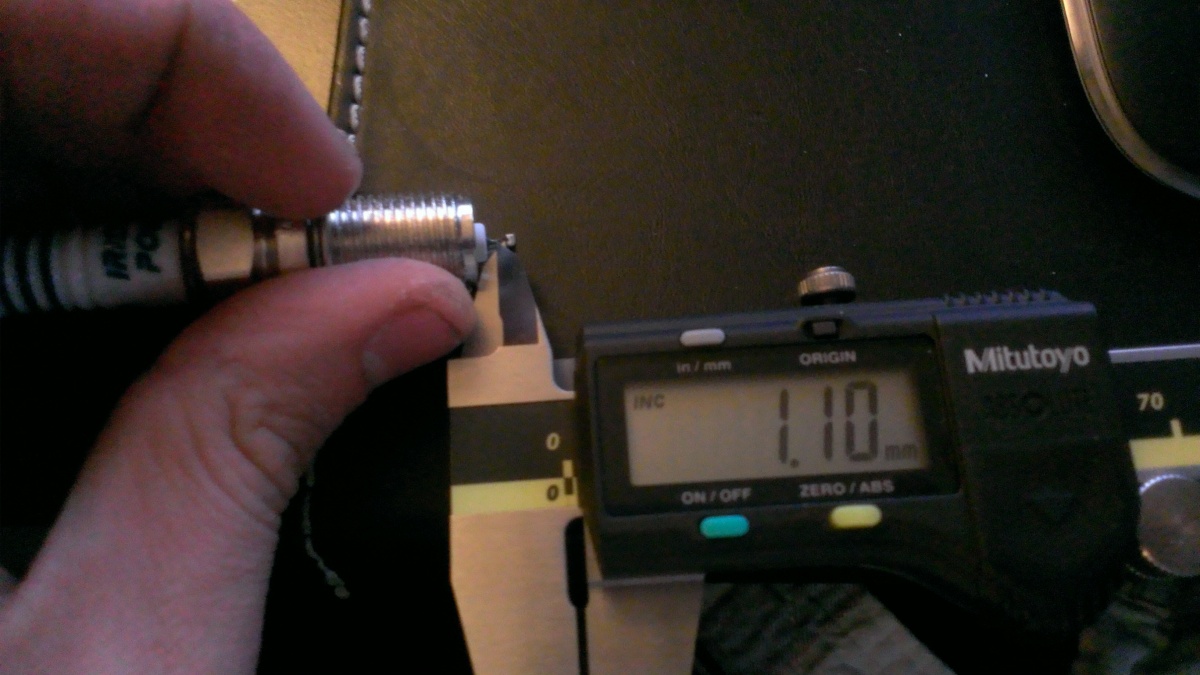

What is the correct spark plug gap? I’ve read some of the other threads and can’t get clarification on this. I measured each plug and got a idea that Denso believe them to be 1.10mm. I know it depends on HP and temp of plug. I am installing the Europipe stage 2 and will probably get the softronic flash next.
Here are the Denso plugs i got showing the gap measured but, is there something better for my setup?
Denso Iridium power IK20 (5304)<O</O
1.10mm<O</O
1.08mm<O</O
1.10mm<O</O
1.10mm<O</O
1.09mm<O</O
1.07mm<O</O
<O</O
Suggestions?<O</O
