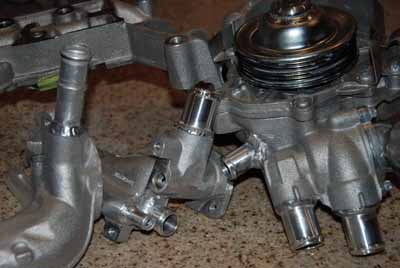

I believe those TQ solution coolant pipes were designed primarily for 996tt? I had to get Betim at BBI to replace the one's the didn't fit on the 997t. You might want to contact him for a complete set for 997t.

Yeah, caused me delay too. Look at the long one on the left (reused stock) and then the very small one (second from the left) -- that's not in the kit. Betim supplied that one. The others are TQ solution pipes. So I shouldn't be too critical. Most of them fit.

So whats to stop me from welding the stock ones in place?

You can't just weld stock pipes "as is" because of the epoxy. It melts and causes a mess and screws up the weld. So you have to carefully remove the pipes and clean all surfaces thoroughly. Removing the stock pipes can cause damage to them if you're not careful.
