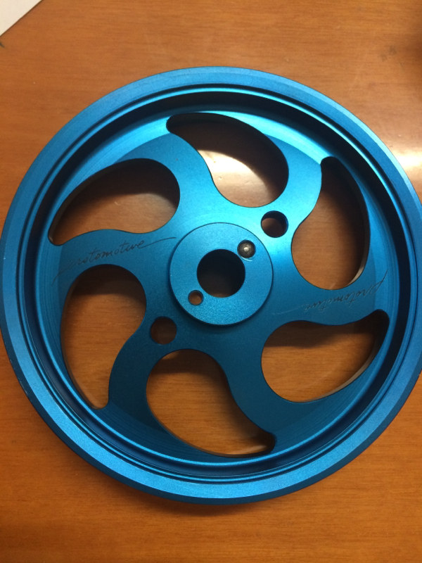

Update: underdrive pulley is gone, the pin dowell broken...
I should have bolt a light inertia one when rebuilt.
Old Mar 11, 2014 | 04:48 AM
  #128
Emre@Esmotor's Avatar
Joined: Aug 2011
Posts: 670
From: Istanbul - Turkey
Emre@Esmotor Is a GOD !Emre@Esmotor Is a GOD !Emre@Esmotor Is a GOD !Emre@Esmotor Is a GOD !Emre@Esmotor Is a GOD !Emre@Esmotor Is a GOD !Emre@Esmotor Is a GOD !Emre@Esmotor Is a GOD !Emre@Esmotor Is a GOD !Emre@Esmotor Is a GOD !Emre@Esmotor Is a GOD !
Hi Pascal,
Its a big problem with these engines. however can be fixed.
You will need a harmonic damper to overcome the issue.
Which flywheel and crank pulley do you have now?
Second thing can happen is flywheel bolts coming loose...
(Porsche has an official bulletin about this issue.)

Originally Posted by Emre@Esmotor
Hi Pascal,
Your motor should be internally balanced and should not need a harmonic balancer.The spinning off of the crank pulley is not due to an unbalanced rotating assembly usually.It is usually the stock crank pulley and lwf combo coming to an abrupt stop when letting off the gas.Double pin the crank and install a aftermarket crank pulley (think Evoms)and the problem goes away.
Hi Pascal,
Hi Emre,
My crankshaft has been balanced during the rebuilt, my Carrillo and Mahle pistons are as well...
I run a LFWL and the stock pulley for now.
My engine is very responsive from low end and I believe it is the issue.
Old Mar 11, 2014 | 08:30 AM
  #131
K24F's Avatar
Joined: Nov 2008
Posts: 833
From: France
Rep Power: 85
K24F has a reputation beyond reputeK24F has a reputation beyond reputeK24F has a reputation beyond reputeK24F has a reputation beyond reputeK24F has a reputation beyond reputeK24F has a reputation beyond reputeK24F has a reputation beyond reputeK24F has a reputation beyond reputeK24F has a reputation beyond reputeK24F has a reputation beyond reputeK24F has a reputation beyond repute
Hi Joe,
Yes as said to Emre my internals are well balanced.
I'm gonna machine 2 other holes for pindowell (at 120°, or 1 at 180° if enough) at the end of my crankshaft and shrink fit a light inertia pulley from Todd or Evoms.
True 750/800ps is an hard drug to drive, but you really have to merit it!
P.

Originally Posted by K24F
Hi Joe,
P.
Hi Pascal,
I just install the Proto pulley on my 3.8l engine using only the factory pin.torqued it at 140ft/lb(190NM) with red loctite.Todd.K said this is enough and no need for another pin.
Old Mar 12, 2014 | 12:35 PM
  #133
Aisxos's Avatar
Joined: Oct 2005
Posts: 287
From: Greece
Rep Power: 34
Aisxos is a jewel in the roughAisxos is a jewel in the roughAisxos is a jewel in the rough
Yes i use the same with no problems..
It is very nice also in appearance.

Internal parts balancing and harmonic balance are different things...
http://www.moparmusclemagazine.com/t...kshaft_damper/
Some birds in USA and Germany told me that several Porsche engines are having broken oil pump issues... (same reasons like loose flywheel bolts, loose crank pulley etc...)
Just my 2 cents...
Just my 2 cents...
Do you mean you bolt some "crankshaft dampers" on your engines?
