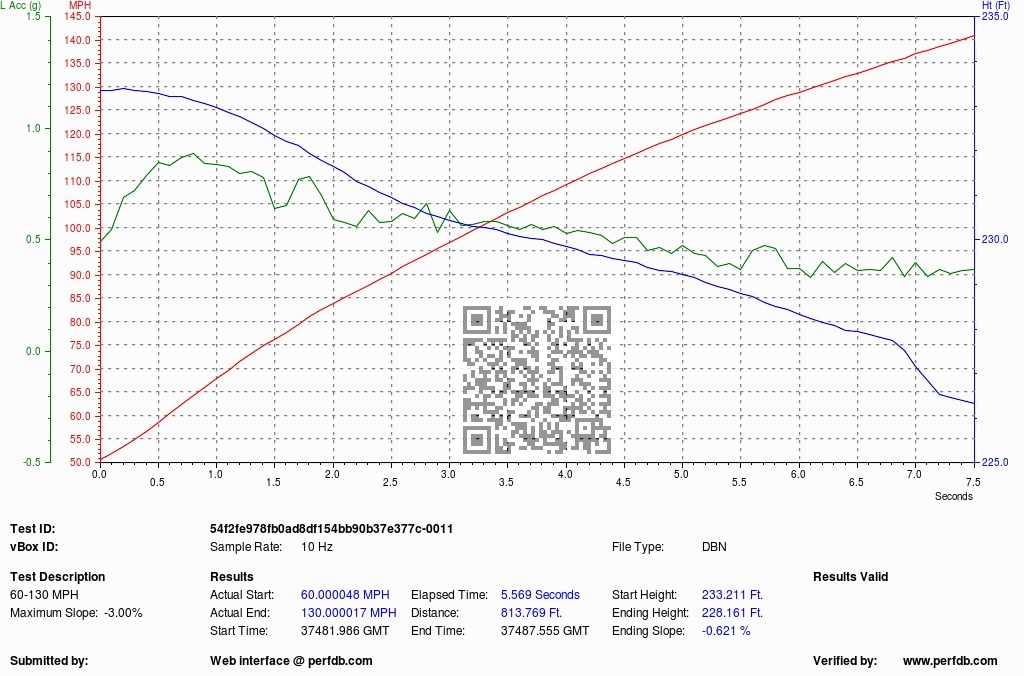

This is my car on pump with 50/50 water meth inj. and 1.65 bar of boost
