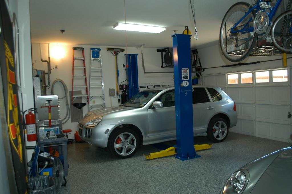

I want to get 4-cars in my 3-car garage.
I already have a 2-post lift and want to stack my 911 and Jag or Cayenne. My ceiling height will not allow me to install the high lift rails and get the 911 high enough to park under.
I already have a Liftmaster 3800.
As for the temps going through the roof I don't agree. My current door is a thin uninsulated steel door. I'm looking at an insulated roll up door. The roll up doors seal just as well if installed correctly and have sealing strips.
Walt

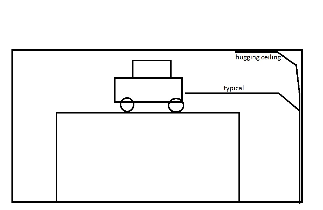

Hello Walt!
Did you take into consideration where the roof of your car would come closest to the ceiling if the door were hugging the ceiling too? You may not be able to get a conventional door that close, but the closer you run the tracks to the ceiling, the further away from the door opening the door will stop when it's fully opened.
Don't know if this makes sense, let me know if it doesn't. I have added a crappy illustration to help.

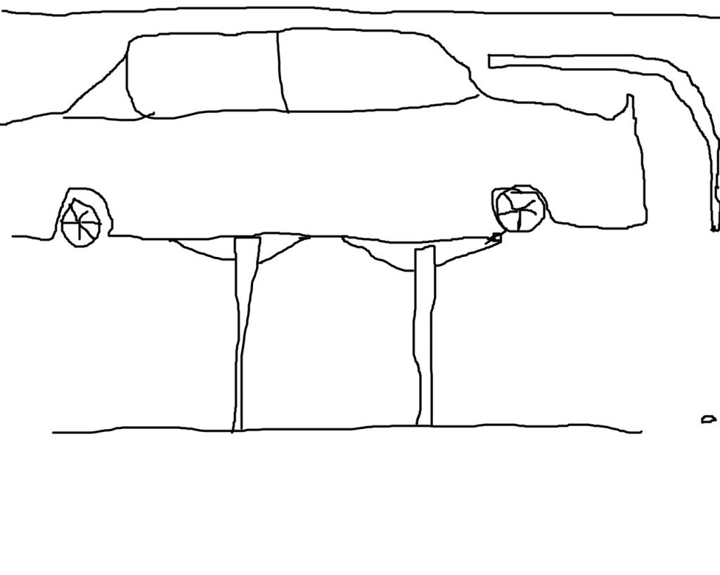

Hi Domer,
Makes perfect sense and I might be able to get away with it.
I previously measured and was skeptical because I need the car all the way up on the lift. The door will not clear the top of the car however I really do not need it to.
Currently it appears that the door, once fully opened via the high lift rails, will be above the rear of the car but just short of the rear window. Another option I thought about is to set the limit switches so that the 7 foot vertical door stops opening about a foot short of normal so essentially the garage door opening will be 6' vertically instead of 7'. That combined with your idea may work out fine.
Thanks for the input. I'll take a picture once everything is installed.

I'll match your drawing with my drawing. Pretty poor I know.
Walt
