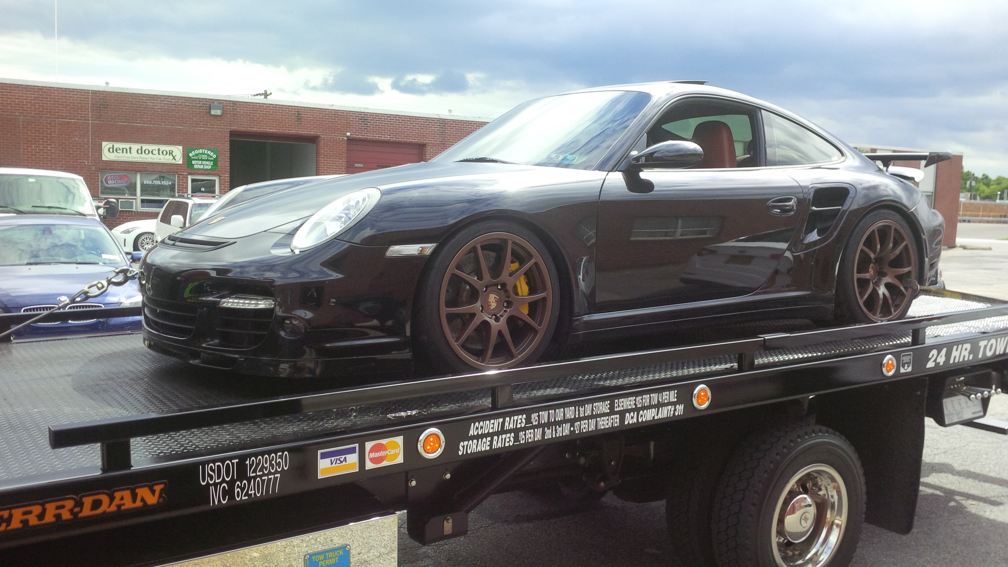

I have no idea what's going on with this thing. I have a bad feeling it's electrical... the nav system kept flickering on and off last night, but the car drove fine.
... this morning however, the battery was completely dead. The engine just cranks when we put a jump on it, but the fuel pumps aren't working...
When it rains it pours im stressing right now.. in the tow truck.

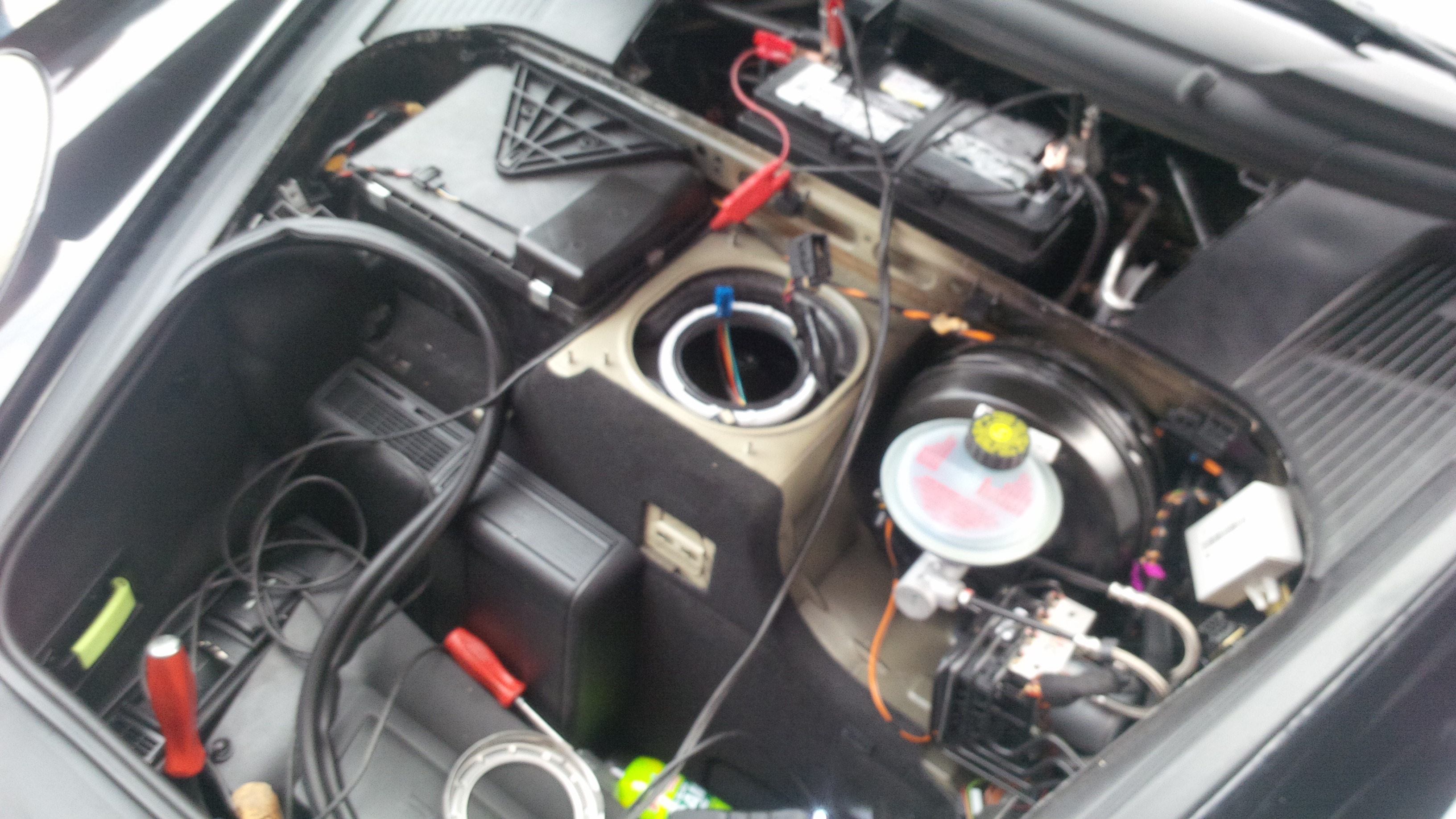

i could not get the trunk open with the method you guys suggested.
i ended up being able to open it by just keeping power into that fuse box outlet, and hitting the trunk button on the remote.
the motor cranked when putting a boost to the battery, but would not start. i cant hear the fuel pumps...
does anyone know where the fuel pump relay is ?
any advice ?
how screwed am i ?

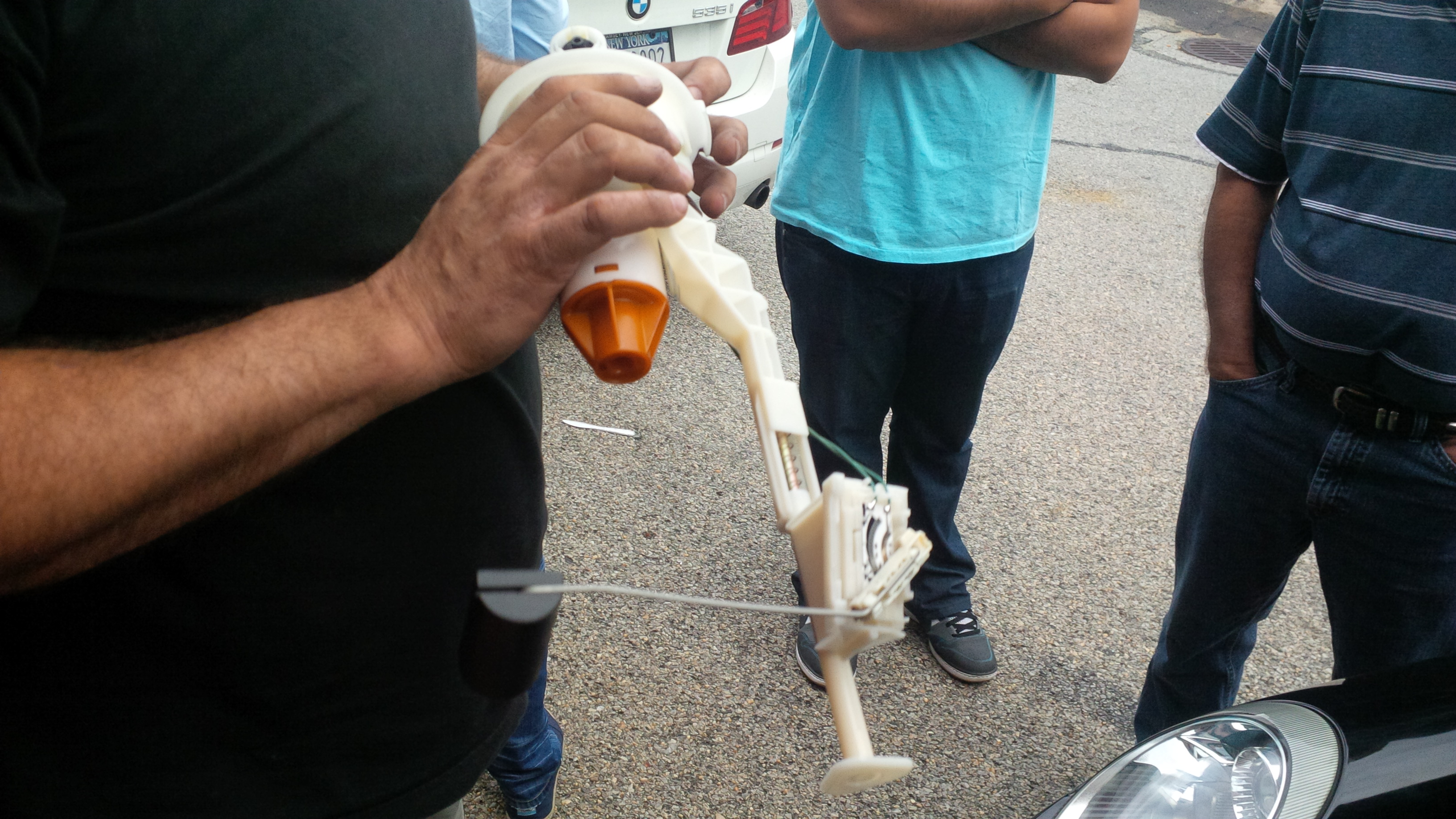

update.
charged the battery up, same problem. car isnt getting fuel.
there was no fuel pressure coming at the back.
we took apart the fuel system up front, and poured fuel into the surge tank. tried again, the car started, then turned off after a few seconds.
tested both pumps, and theyre both working. topped off the gas tank. tried again. car wont start.
