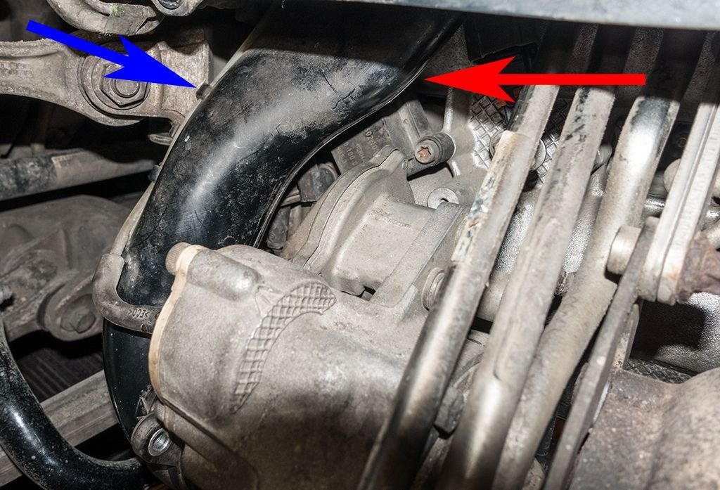

And this is the real problem. The blue arrow is where the black pipe hits the mount for the upper control arm and it just won’t go forward any further. The red arrow is the part of the pipe that is too close to the coil to get anything in there to disconnect the clip and access the upper coil bolt. At the bottom you can see the amount the pipe is out of the turbo; it will pull toward the front of the car about an inch.

The top line is part of the SAI system I did not remove mine if you look at the engine out picture it will drop with the engine.
The smaller 1/8" line just pulls out of the rubber elbow into the turbo.
The plastic turbo intake pipe I just pried it out of the way to provide access about 2"-3" you can PM if needed.
Glad the coil pack connectors are good 2 of mine were so brittle the snapped off.

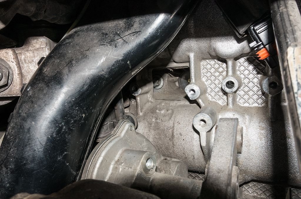

Success finally. So what worked for me (for the driver’s side front plug):
- did have to drop the engine a few inches
- did not have to take the top line off the intake pipe after all
- moved the black air tube away as far as you can to try and reach the clip on the coil
- give up: there was absolutely no way my hand/arm would fit in there, so have a mechanically inclined wife with strong but thinner arms reach up and unclip the coil for you (!)
- the rest was easy; undo the 3 bolts holding in the VGT controller, unclip the rod ball joint at the top and just let the controller drop a bit out of the way. I did not undo the oil/coolant lines, or loosen the headers
- coil and plug comes right out
