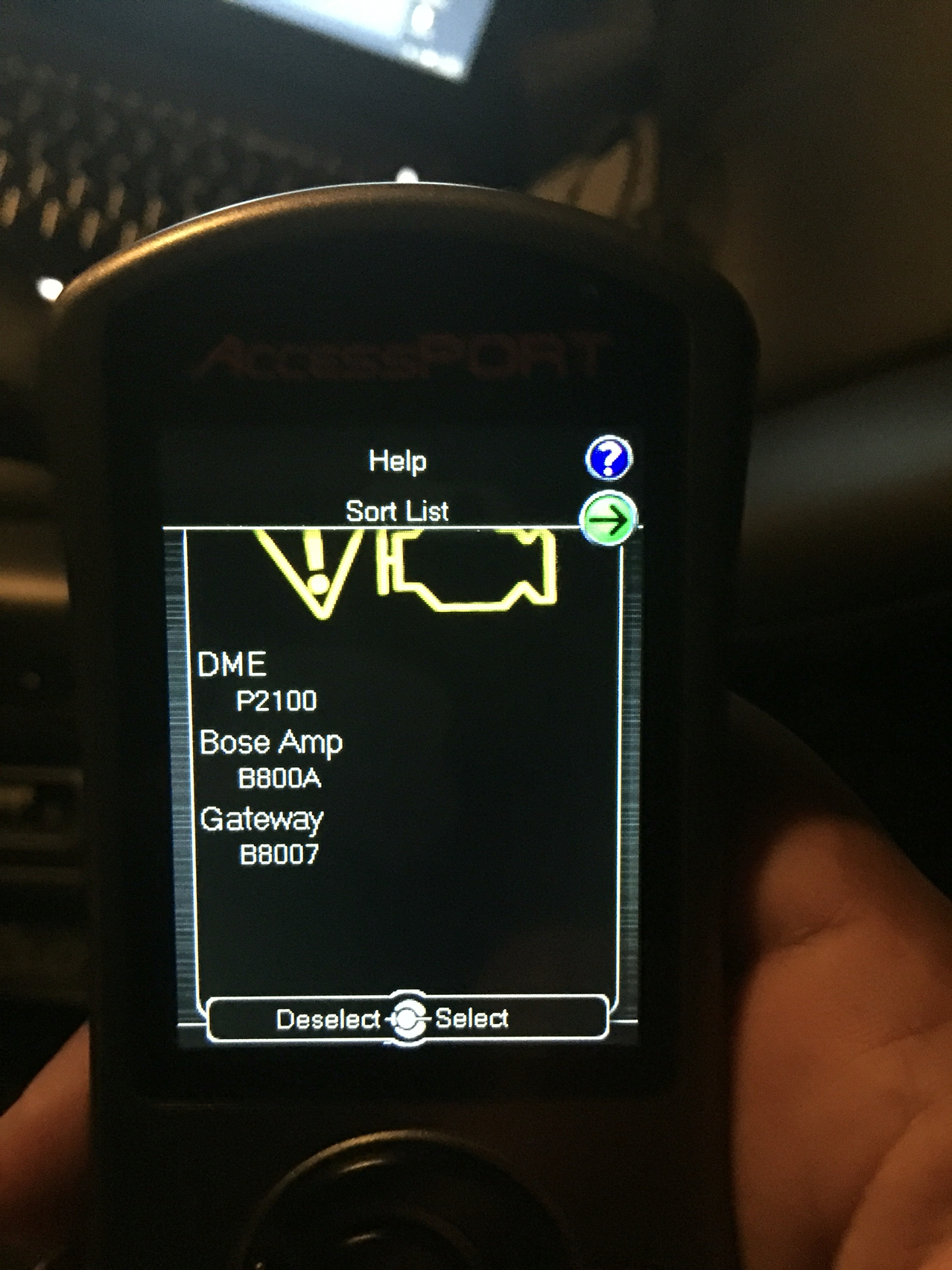

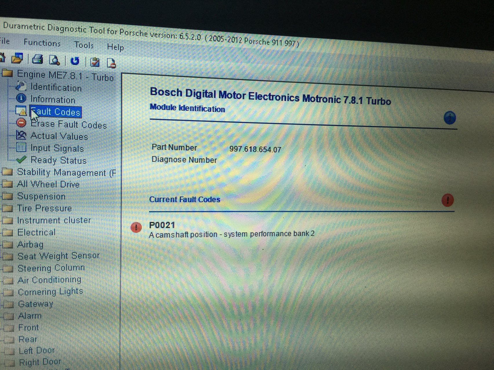

Pulled p0021 on durametric last night. Read up on error....cleared code. Drove to work just now...13miles in and AP pulls p2100
Is there anything I can log with the AP to see which issue it really is?

^ What version of Durametric are you using?
I know in MY specific case, using Durametric version 6.3.2.5, it will transpose the codes from a 0011 or 0021 to a 1100 or 2100.
My Torque app CORRECTLY reads it as P0011, which in my case was the spun cam issue that required a new intake cam to be installed.
Depending on what version of Durametric you are using, I would be inclined to believe your Cobb AP as correct, which is probably good news for you
So tomb18 above may be correct in that Durametric fixed the transposing code issue a LONG time ago, but all that matters is WHAT version of software contains the fix(es) vs. what version you are actually running on your laptop. In my case I can confirm that version 6.3.2.5 does NOT contain the fix.

It is a fresh install as of last week on my laptop...so whatever I was able to download off the website. I cleared the code again. I am going to perform the throttle reset procedure before driving home. If it pops up again, I will read the code with both tools (Durametric and AP) and post findings and proper software/firmware versions being used.

I am getting two different codes using Cobb AP and Durametric
Anyone have a way of confirming the issue without a trip to the dealer?
