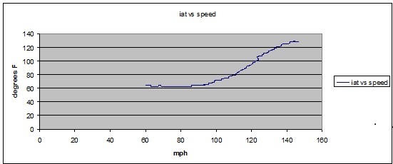

Champion 68s exceed capabilities of GT2RS/.2tt intercoolers
I have Champion 68s, Cobb tune, catless AWE exhaust and other supporting mods. I go to Mosport once a year and datalogged with the Cobb Accessport. I run a tune with 22.5psi boost from about 4k to redline. There have been a few threads saying that vtgs cause high iats if high boost is used on long pulls.
For 99.9% of my needs the tune works without issue. The graph below will show that the iats do climb on the longer pulls and then timing gets pulled, the lambdas get rich, and boost is reduced. Obviously performance is then reduced. At the start of the day I was able to pull my friend's 2015 C7 Z06 with upgraded tune and CAI. After the iats rose we were pretty even. Clearly this will not do!
hmmmm....I'm having trouble uploading the picture, let me try again...

Around 140mph the iat exceeds 120F and things start happening - lambdas get really rich, boost drops, etc... Ambient temp was in the high 50s or so.
The options are: lower boost, accept this performance drop for the 1 day a year track day, get better intercoolers. I'm sure someone will say "get alphas" but I'm not interested in changing these vtgs.
Is there any proof that another intercooler would be able to keep the iats down below 43C or so on my car? I'd be interested in a modestly priced I/c if it worked but no interest in spending 4gs for AMS I/cs or similar.

Are you sure that's it's the IAT that causes that performance drop around 140 mph? You're just at 48C (120F) while the safeline IIRC is 55C (131F). Have you logger EGTs, the cause may be there...if you're above 980C (1767F)? Which is quite possible with those turbos, big compressors with relatively small turbines.
I did a small experiment with my own car, adjusting control vane settings at upper rpm/boost range while the boost was dropping slightly from desired (1.3 --> below 1.2) over there, this based on 3rd/4th gear loggings at track. Yes, I got "better" boost curve, but the EGT also rose, quite much. Especially in 5th/6th gears. I did one airport mile run in September and the log wasn't anything beautiful to see...:
-delta T 44C with max IAT 74C! (rise stablized again at 250 kmh)
-max EGT 974C (exceeded 950C at 265kmh)

There simply isn't any way to make a tune that performs to its utmost for every possible situation. For instance, for most situations such as a good street tune, 60-130 runs, 1/4 mile you want to run the motor in a way that maximizes its area under the curve, otherwise, you're not using all of its potential.
On the other hand, without appropriate cooling systems in the car such a tune can't be truly ideal for 1 mile runs, 30min road course sessions where most of the time is spent at WOT, etc. I know given its coming from me it may come off as a marketing pitch but I truly believe and know from experience that customizing your tune to what you need for a given set of driving conditions is the ideal way of approaching it. We work with race teams all over the World and our tunes are always custom to their needs. A lot of times from the tuning side of things they're boost limited, airflow limited, etc. We have cars coming out 1st in class in 12hr races in Australia in horrible conditions but a tune made for a car that'll go through that sort of racing is nowhere close to something you'd want on a car seeing mostly street duty as it'd be weak/boring and leaving a ton of fun on the table. You have to balance everything when customizing the tuning and advise the customer accordingly. It is simply wishful thinking that one tune can do it all, bottom line.
Octane and intercooling always help. I keep mentioning methanol injection not because of just octane but because the tune made for the street where area under the curve is maximized has a much higher chance of staying consistent without incurring heat soak if you take it to a road course or 1/2-1 mile events. Many race teams run meth for these exact reasons.

I'll check egts and see what they are doing at the speeds up to 140ish. Maybe you are right, Pete. I have catless AWE but it still may not be enough to liberate the hot gases.
