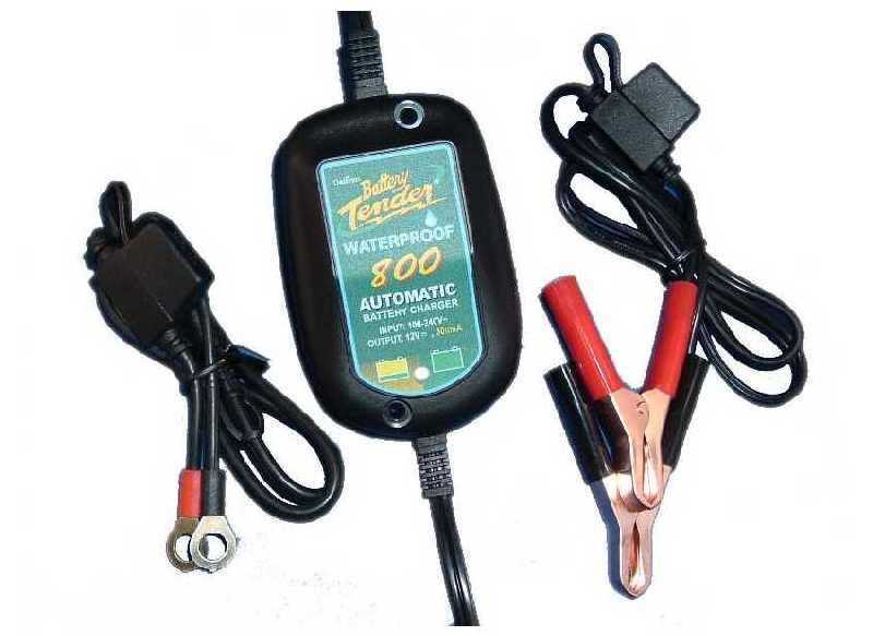

Battery Tenders (By Deltran) have long been considered the best in the industry.
They run roughly $35. I have a couple.
They all come with hard-wired leads like the OP mentions.
Here's the standard model showing the HW lead in the front left.
And the waterproof version.

The Deltran works too, but I like the construction and results I have had with the CTEK better. JMHO and experience. Thought I would pass it along.
I use their cigarette lighter adaptor and it works marvelously! no extra wires and easy access.
