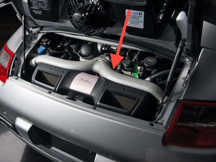

stef@europipe Is a GOD !stef@europipe Is a GOD !stef@europipe Is a GOD !stef@europipe Is a GOD !stef@europipe Is a GOD !stef@europipe Is a GOD !stef@europipe Is a GOD !stef@europipe Is a GOD !stef@europipe Is a GOD !stef@europipe Is a GOD !stef@europipe Is a GOD !
The sensor is located under the right side of the Y-pipe.

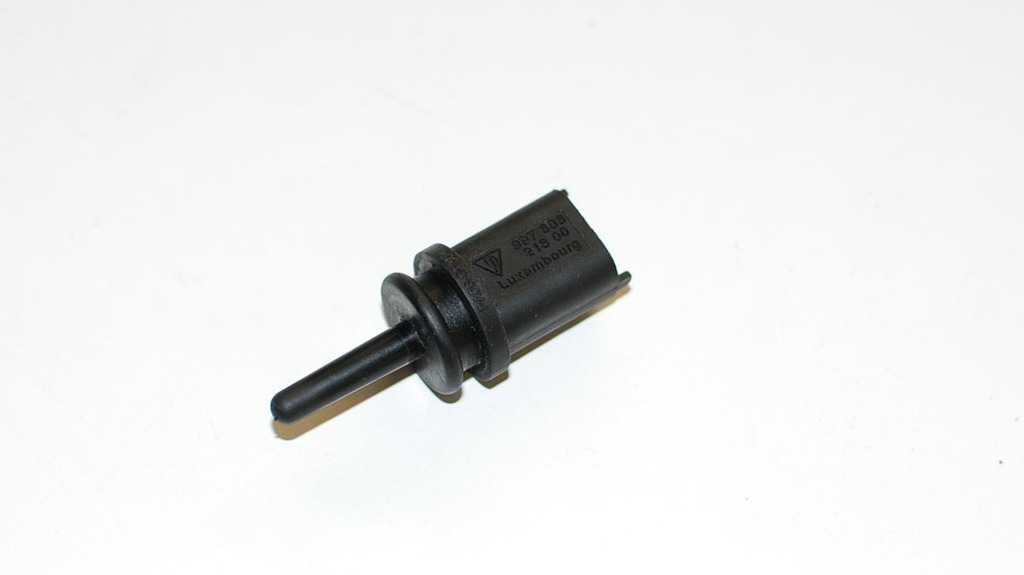

The sensor looks like this
