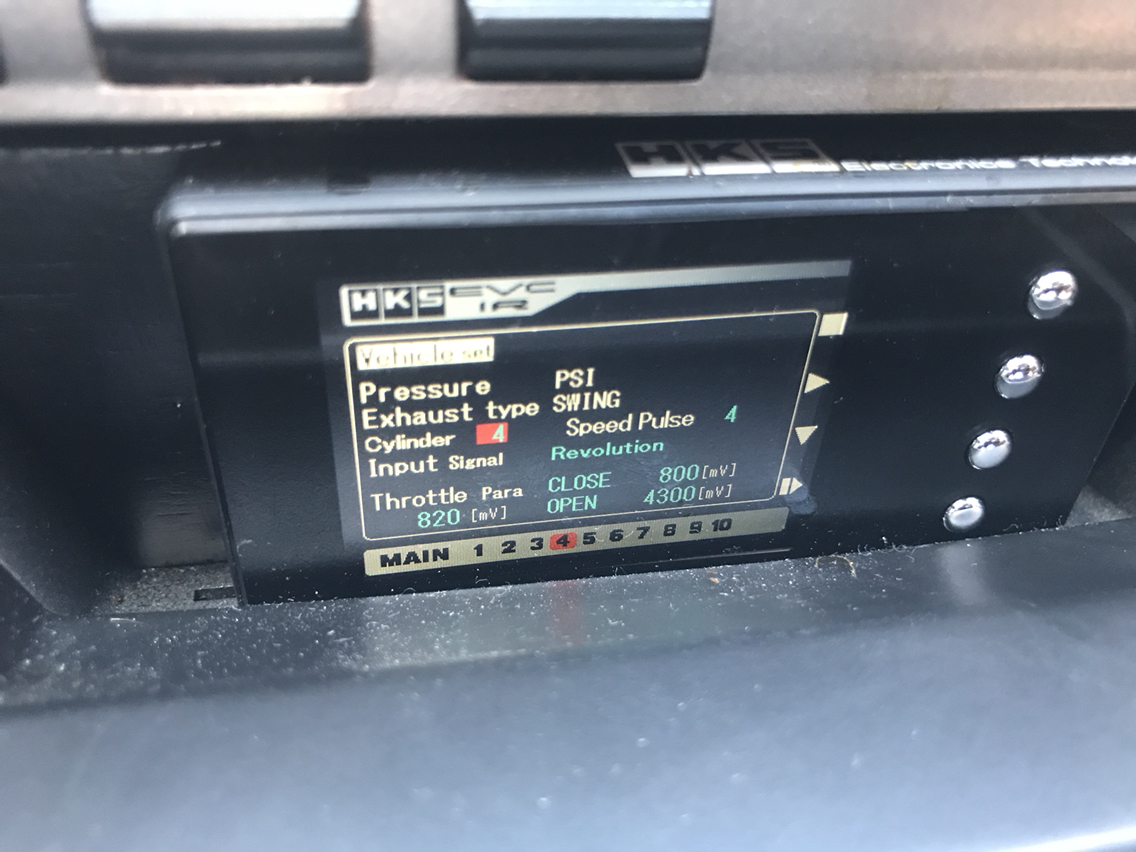

Throttle is hooked up properly you can see the open and close percentages with the motor off but ignition on. Seems fine. Waste gates under pressure with gauges on them start to crack at 14.5 psi. What should my standard max boost be set up as as well as the initial offset?

Throttle parameters with pedal not touched and pedal to floor with ignition power on motor not running.

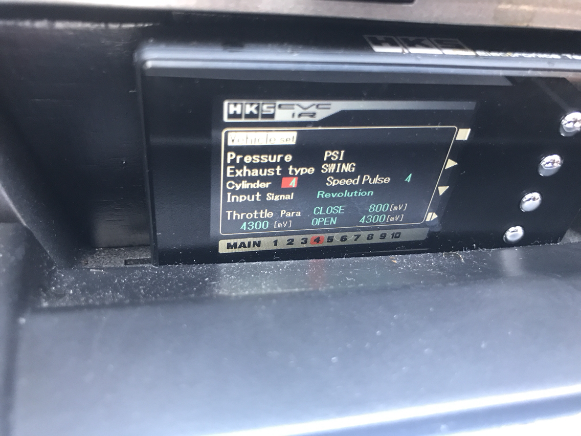

We actually ended up figuring it out. We set the throttle setting with the car off like the manual said. However with the car running the no throttle position( the starting point) dropped by 150 value. So we reset the throttle to accommodate for that and we instantly made 25lbs of boost. Then we started playing around with the efficiency at like 80-90 percent to to get it to peak at our max boost variable. We were able to get it down but was still overshooting by like 1-2 psi. Next week have dyno timed book so will finalize it on there. Thanks guys. Big difference between 20psi and 25
