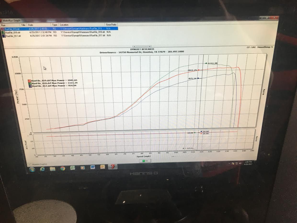

I've waited long enough, so it's time to share some numbers. Here's what the initial dyno numbers looked like. Unfortunately no one seemed to think of making video, but I hope to fix that sometime soon with some higher boost pulls.
The first power pulls that were done were just on wastegate spring pressure of ~14psi.
711 to the wheels on wastegate spring pressure and 93 octane. That's pretty much what you'd get out of upgraded VTGs on e85(!)
I was having a pretty good day at this point, I started getting text messages with the dyno graphs. It was a fun day of guessing what the car would ultimately make. I had been hoping for at least 600whp on these settings, and it did 700. This is literally the least amount of boost the car can run without swapping springs in the wastegates.
Next we moved on to pushing pump gas a little. It actually made a little more than this on 93 on one of the pulls but I don't have a picture. It was 950+.
935whp pushing 93 octane a little. There was quite a bit left but I was really impressed with these results and if I'm going to lean on it a bit I want to do it with good fuel instead of pump gas.
We swapped over to Ethanol and did a few more pulls as well. This last sheet shows a few of the pulls.
The best pull was 1111 to the wheels. Quite an interesting number! We didn't turn things all the way up on the dyno, this was still relatively low boost.

Really nice!! Do you happen to have the dyno charts with RPM instead of speed?

Power looks good. Congrats!
If you have the .drf files, switch from MPH to RPM so people can see the spool. Dyno shops like to show MPH because it always reads higher. You will lose a few HP with RPM but it's better data to show people. Also, show your torque curve on the right hand panel.
What was your boost at 1111 WHP? It looks like the turbos are starting to pass their efficiency range.

23-24psi maybe? I'm not 100% sure. We're tuning more to torque output & turbo shaft RPM than boost. I'm keeping torque under 950 ft lbs to protect the transmission.
There was still 30-40k rpm of turbo shaft speed left, I think I'm going to add a couple pressure sensors to work out if it's the BBi exhaust choking things up or if it wants a larger turbine housing.
I do have the dyno files, I'll probably have to give it gearing information to get torque. Steve didn't have the right tach adapters for the dyno to read RPM with the M&W ignition. I've been meaning to do that but haven't gotten around to it yet.

Oh, I should mention that this pull was a case of overshooting the torque limits. It went up to ~1000 ft lbs for a little while and then came back down. That's what the odd shape of the curve is.
