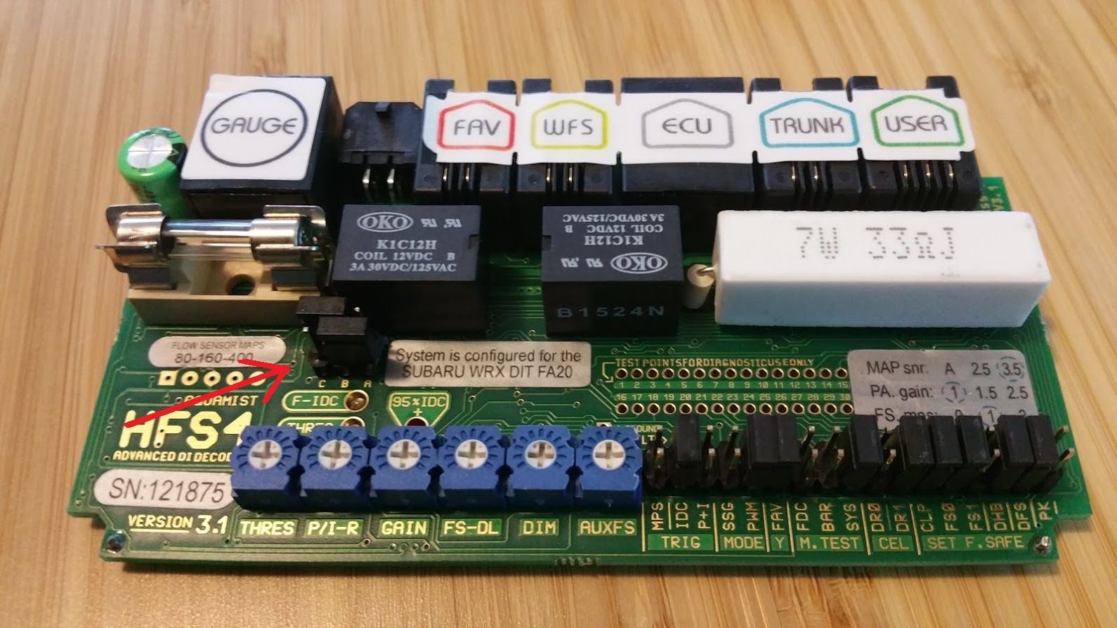

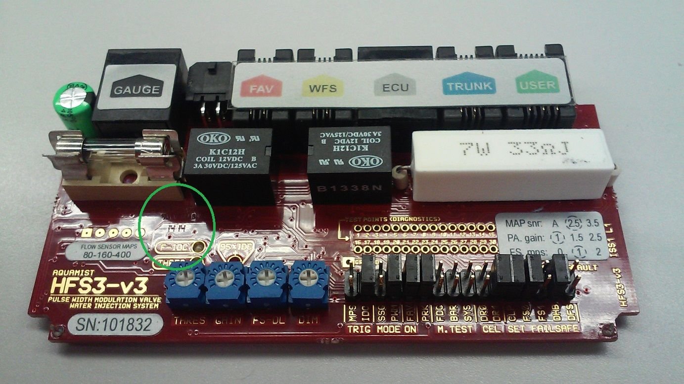

But starting with the V.4 version of the HSF-3, (Fall 2015, Spring 2016 ish?) they started coming equipped with an injector scaler. It has settings of 1.0, 1.25, 1.5, 1.75, 2.0
So if you install large injectors and now are only hitting 45% duty cycle,.. you can set the scaler to 2.0x and the Aquamist will run 2x that,.. or 90% when your injectors are at 45%.
My car sees a max of 56% with ID-1000's,.. so I have my scaler set to 1.5 x (or 84% at max load)
This HSF-3 V.3 does not have them. Green circle)
But this HSF-4 does. Red arrow. (Move the jumper blocks around in various configurations to select the multiplier you need).
At home I have a pic of my HSF-3 V.4 board which has the scaler.
