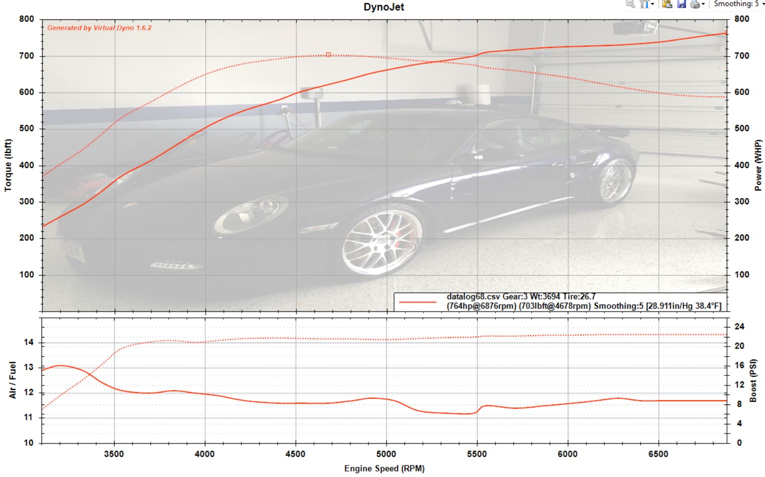

Here's a boost comparison. It's not the latest wastegate log, but I don't think the wg pressure changes when the tune is revised. The wg log didn't go all the way up to redline on this pull. The other log looks just the same, lol, but I'm requesting more boost than wg.
The "flutter" above 6k rpm is probably because the wastegate pressure and requested pressure are very close. Over the next couple of days (depending on weather) I'll see what happens when I request even more boost....
Car is already pretty quick, almost at the "goals" I had set for the project.

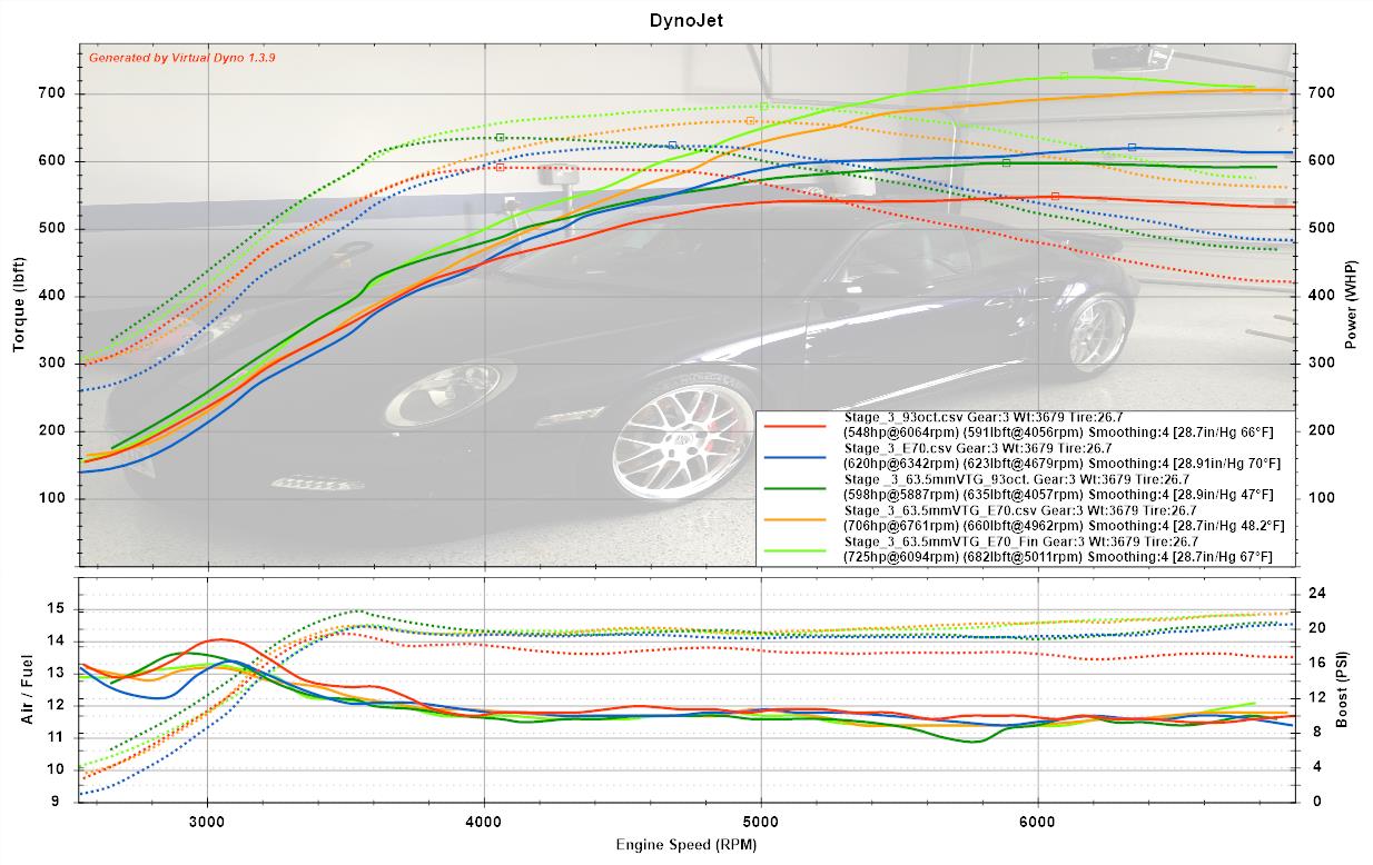

08957 here is some data on my stock turbos (red & blue curves) vs. Proto 63.5 showing progression over time. Ambient comditions are on there and everything is SAE corrected. I also attached the final calibration we did last year.
I don't have a good data on the Champion 68s Bogg had, the few logs I have the calibration was terrible so I threw those out. I do have a lot of data on Sam's 68s now, from logs I was expecting 750-760whp on stock internals, it was proven out this year on a dyno. A built engine car went 799whp I believe on those.
On E85 my car has no problems breaking traction, can even crab walk into the next lane in good weather I don't bother flooring it on 93oct...spoiled I know This data should give you an idea if upgraded vtgs are of interest. Obviously not the end all here but its my experience.
What software do you use to get these dyno simulations ? I like the way you have presented this information. Very useful. Thank you
