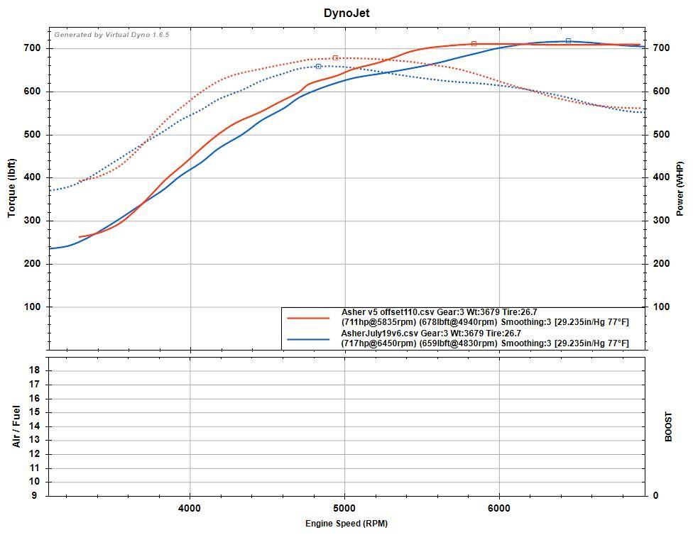

Just a little update: I've put on a few thousand km with the Xonas and so far so good. I changed the oil last weekend. I must have done at least 30 3rd gear datalog pulls! I was looking back at some of the July datalogs and wish I'd been more meticulous about writing down the settings for each run. I started doing that later on but not so much in the beginning. Also, I didn't realize it in the beginning but when you make a change in the boost controller you need to give it time to make the change by doing multiple runs and power cycling the car.
So far I did a 4th gear 60-130 on pumpgas in 6.7s. There's at least another 0.5s to come off that time because it doesn't hit hard like my 68s or some of my other versions of the tune...but I figured it out. Check out the graph of v5 vs v6:
This is a "virtual" dyno result courtesy of Sam based on my datalogs. V6 differs from V5 only above 6k rpm by adding a tiny bit more timing. I couldn't figure out why the curve was so much "nicer" in v5 until I went back to my notes and realized there were some targeted boost increases in the v5 graph so it's not an apples to apples comparison. Anyway, I'll add a little more down low in v6 to match what v5 did, which puts it around the same whp and wtq as the other thread shows (on 08957's car) at 4k rpm and I think that will really help the times because once it starts pulling it hauls butt!
