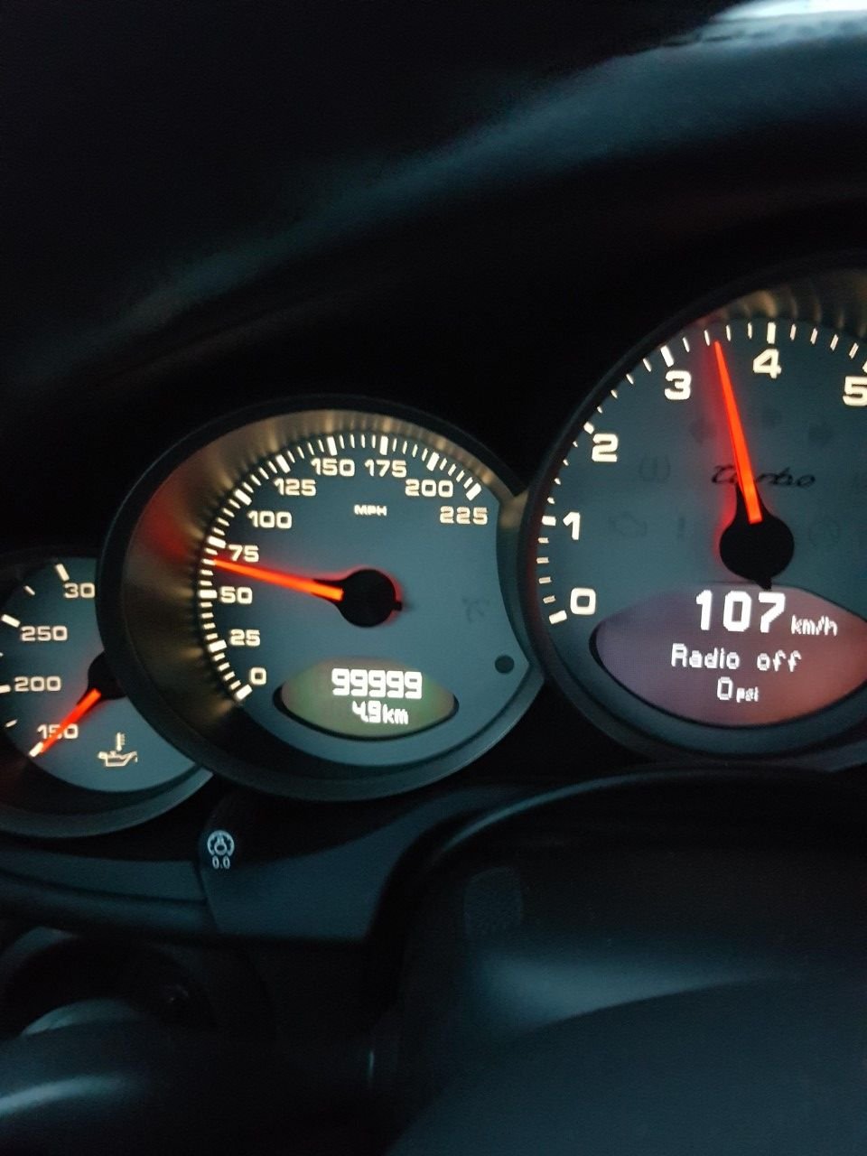

Baby's about to hit the 100k mark! It's in km which is about 67k miles for those of you who don't use metric...

Congrats �� on the milestone! These cars are so solid and reliable ..... many more KM of boost and 911 enjoyment my friend!
