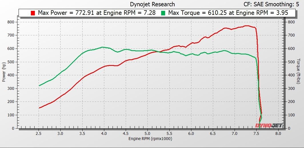

Congrats on your car! Sam also did a fantastic job tuning my car with the XR980s. We went through 14 versions of the tune to get it perfect as we had a few hardware changes along the way. On very conservative 91octane file running only 19psi, we are putting 773hp to the wheels. We severely detuned the midrange from 720 ft.lbs to 610 ft.lbs in order to get a nice GT3 type power curve to make the car useable on the road course. Can't say enough about Sam, he did a hell of a job. Our plan is to swap in GT3 heads this winter to allow for a 8800 redline which should net closer to 830 at the wheels at 19psi.

Nice dyno plot, powderhound! Looks like it hits hard right from 3500rpm. Damn, I need a built engine, lol.

Originally Posted by pwdrhound
Congrats on your car! Sam also did a fantastic job tuning my car with the XR980s. We went through 14 versions of the tune to get it perfect as we had a few hardware changes along the way. On very conservative 91octane file running only 19psi, we are putting 740 to the wheels. We severely detuned the midrange from 720 ft.lbs to 625 ft.lbs in order to get a nice GT3 type power curve to make the car useable on the road course. Can't say enough about Sam, he did a hell of a job. Our plan is to swap in GT3 heads this winter to allow for a 8800 redline which should net closer to 830 at the wheels at 19psi.
WOW! You have a VERY efficient set up there to be making that power with only 19psi on 91craptane!....and you guys backed it down from a street tune on top of that. Very nice & congrats!
